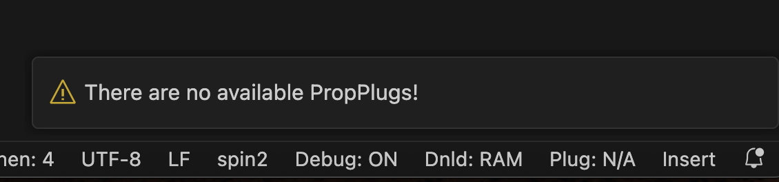

they are not available, Toolbar always show:
If you click on the toolbar item for the prop-plug selection, you can select one of the two prop-plugs.
Once you select one, it stays selected when you return to this project.
Lastly, remove (unplug) one of the prop-plugs and open a new project with spin2 code in it. The only prop-plug should be automatically selected for you in this case.
same with a new project and only one official prop plug.

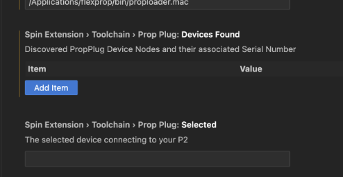

@wummi what i don't understand and we need to figure out is why the report says there are two propplugs and why the toolbar says there are none. That's inconsistent and broken. Can you show me what you see in settings:
I'll work on enabling the setting to open up the gate to allow non-propplugs, but I don't know how to predict (code for) the ability to toggle DTR/RTS on these foreign devices.

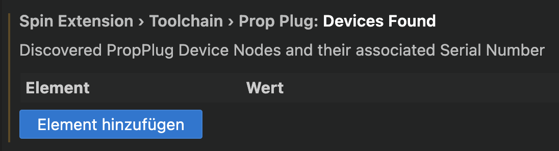

@Stephen here the initial Devices List

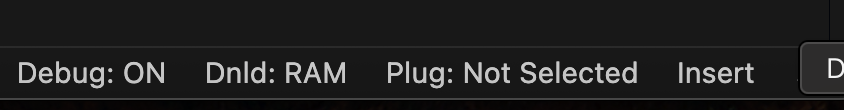

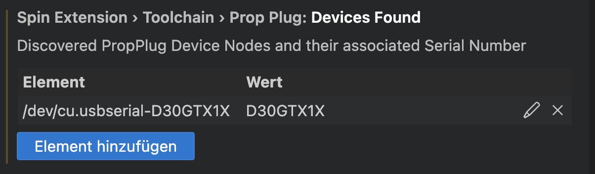

I can add the Device manually
Then the Toolbar changes to
When I click Plug: Not Selected, the Device List is cleared and in Toolbar Plug: N/A is shown.

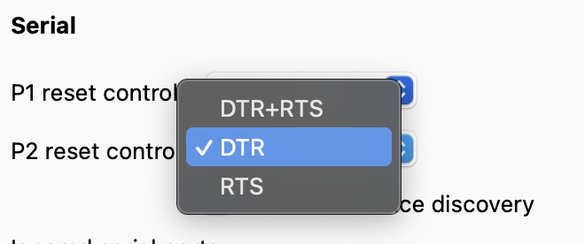

DTR/RTS select:
In Spin Tools IDE we can select:
Implement like this:
