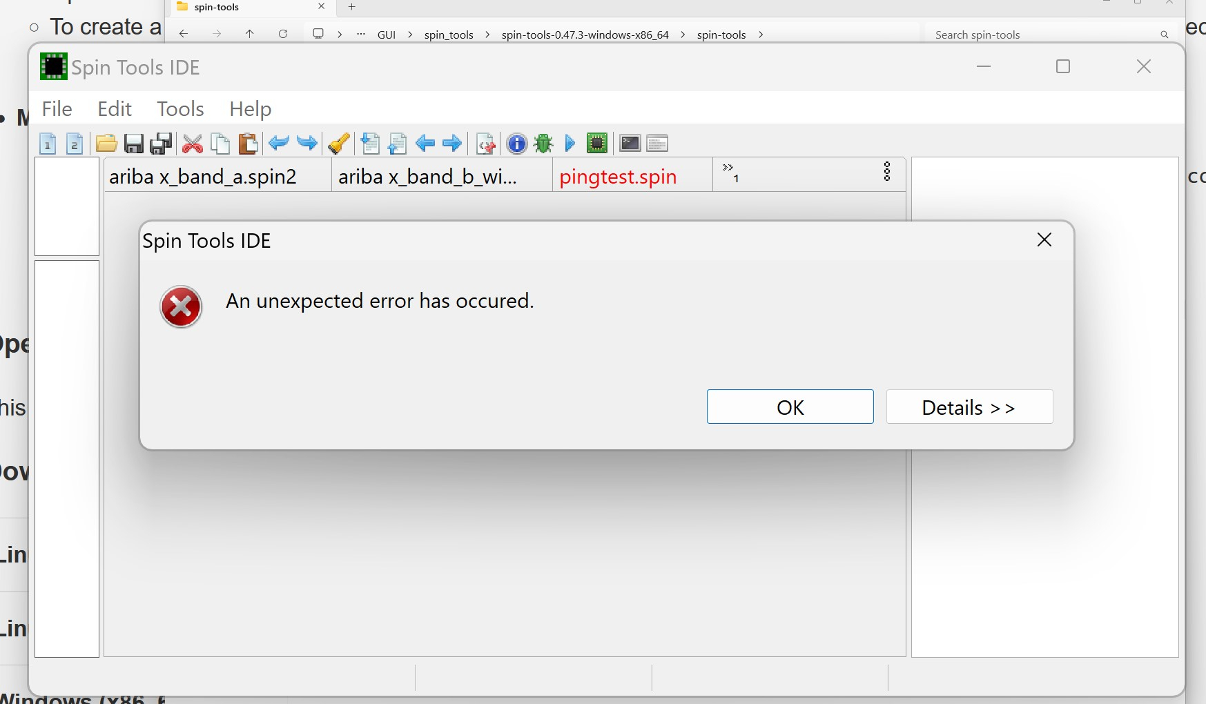

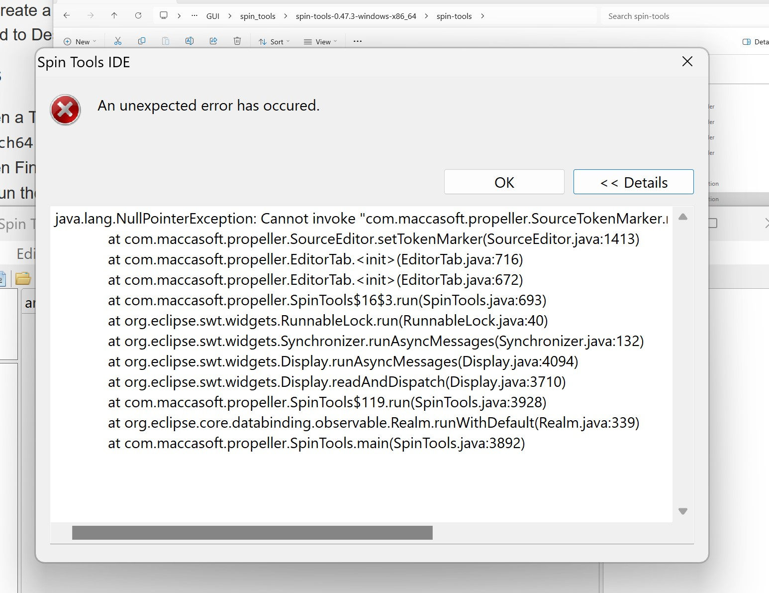

@pilot0315 said:
Just downloaded spin tools again. Got the following error please see attached. Sent same to your website.
One of the files opened in the editor has an extension other than .spin .spin2 or .c ?
Because seems that it opened an unknow file (the editor should prevent that but for some reasons it failed).
@pilot0315 said:
This occurs when I double click on the icon to open the ide.
Right, delete the preferences file .spin-tools (note the leading dot) in the user's home directory.
Alternatively, open the .spin-tools file and delete the "openTabs" property (if you are familiar with json file format) but may be better to delete the file.
Thanks
Martin
@macca
How do I fix this.
Thanks
