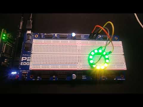

I have this kit with 37 sensors from Elegoo off amazon (see pics below). I was wondering if anyone has written P2 drivers for these?
I ask because I'm looking to increase my knowledge in P2 SPIN and PASM and I would write drivers for these (attempt to) and then provide the resulting drivers for the forum to use or refer to.
While you are here check out my video:
SPIN2 files for the neo pixel circle are attached. SPIN code with in-line PASM

    As you dig more into PASM2 you'll find some nice surprises. For example, in the P2 you can swap the red and green color bytes in your WS2812 code with one line of code.
                    movbyts   colorbits, #%%2310                    ' $RR_GG_BB_WW --> $GG_RR_BB_WW
    Write drivers for the kit. If others do, too, that's okay. We all approach things differently and can learn from each other.

    @JonnyMac thanks. That's a neat trick which reduced 5 lines of code down to 1. worked great and code attached. Ok great. I will work on the drivers and share them with the forums, if i'm successful. Will be a challenge but fun.
    This is where I struggle. As more of a beginner, I would not have figured out movbyts from the large excel sheet (v35 Rev B.). The excel spread sheet can be difficult for me to understand. Also the PASM user manual does not have movbyts finished yet. I've been looking forward to the user manuals becoming more complete. I mostly use your JM code to learn for now.
    Now I learned a new one (i.e., movbyts).... so i can add another "tool" for the tool kit. thanks.

    My original P2 port of the pixel driver didn't have it either. I try to spend a little time every day looking through other code and I happened upon it. When we have a P2 manual that's like the P1 manual, it will be easier to find and learn to elements of the language -- and the P2 has a lot of new elements.
    Suggestions:
    • Many of the variables you're using in the output function -- which have to be passed to the cog to run -- can be replaced with constants.
    • With calculated (which happens at compile time) constants, you don't have to worry about a specific clock frequency
    • Spin allows direct byte access of words and longs
    • The return value(s) of a function are preset to 0 -- you don't have to do that in code.
    I had a small LED ring handy and tested these updates to your code (i.e., they work). As they say here in Hollywood, they are for your consideration.

  • Thanks for the tips and the code! Will adopt the clock constants. That byte access is very slick.
    Why does the RESETD constant have ## and the other constants have #? The manual says 9-bit literal versus a 32bit... RESETD value is decimal 10,000 which is larger than decimal 511 (max of $1FF). Is this the reason?
    setup                  drvl      pins
                                waitx     ##RESETD
    I've started the HDT11 sensor driver (sensor 1 or 37) which I already have a P1 PASM driver for but will convert to P2. I'll post a draft for the forums to review.

    Yes. The assembler inserts the augs instruction to deal with the 32-bit literal. This is important to know if using rep with a fixed loop count (instead of @label). For example, the shift loop could be written like this:

    But if any of the constants used ##, you'd have to count that as two instructions.
