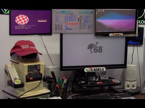

  • hinvhinv Posts: 1,256
    Here's why to run the 68000 on the raspberry pi for games that really could use the performance:
    Emu68(bare metal emulation, currently of just 68000, ram and hard drive) on a $15 Raspberry Pi Zero 2W is 1135times as fast as a 7MHz Amiga! The Musashi emulator runs on top of Raspberry Pi OS and runs the emulator at about 32x as fast (on the $15 Zero2W) as a 7MHz 68000, and also give you RAM, HD, Network, and RetargetableGraphics (hdmi out), and I think even USB input device while it uses the Amiga hardware for floppy, keyboard, mouse. Chip RAM, Agnus, Paula, Gary, Denise, and the CIA's. I'm thinking that Agnus, Paula, Gary, Denise, and the CIA's can all be emulated by the P2.
