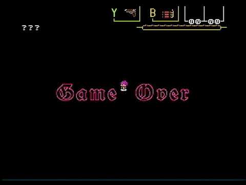

    So I just did another batch of archive videos and for the occasion, I figured out what the optimal settings for the UTV-007 EZCap/EasierCAP are, to get it too look as close as possible to my actual TV:
    (excuse the German..)
    Previously, i'd set sharpness (really just an artificial sharpening filter, 128 is waaay too much) to 32 and everything else to 128, but that doesn't result in perfect blacks and whites. Annoyingly, it sometimes forgets the settings and set itself to random values... Oh the wonders of cheap electronics.
    Also interesting: It does auto gain control on the incoming signal, unlike basically any TV. So if I have both my TV and the capture hooked up, the TV becomes dark due to double termination, but the capture doesn't.

  • The video capture saga continues!
    New contender: Phillips SAA7134-based PCI TV Tuner card, bought for 7€ on eBay
    Being a PCI card, one may need to dig up an older PC to put it in, but luckily my main PC has a PCI slot, so I just put it in there.
    These are of course no longer made, but it's not super difficult to procure one with this chipset online. The other (slightly more?) common one is from Conexant, IDK how well that works.
    Okay, sooo....
    The Quality on both composite and S-Video is leagues ahead of any EasyCap I've seen. On S-Video it looks more like a low-quality JPEG of an emulated screenshot than an analog capture.
    BUT the (Win7 64bit) driver is once again a bit of a trashfire:
    - Doesn't work at all with AmarecTV (just gives an "unknown error" box when trying to open the device)
    - OBS Classic works but is unusable, the crossbar always resets back to the S-video input when stopping the preview and the feed has weird corruption in it.
    - OBS Studio has the same issues, but due to how it never closes the device, the crossbar resetting is less of an issue and for some unfathomable reason the corruption goes away when you start actually recording (doesn't on classic...). You can see it a little bit in the first second of the test recording.
    - Only reports 768x576 as available (and stretches the combed video to that when selected, ugh), but manually forcing 768x480 makes it nice and 1:1, allowing for custom deinterlacing.
    - It hasn't BSOD-ed my system yet or inexplicably stopped working, so that's cool I guess.
    Here's a test recording over S-Video:
    Here's a still with the corruption. Note that not every frame has corruption and most frames only have one or two corrupted lines, it's only really bad in motion.
    5312 x 2988 - 7M
    981 x 736 - 531K
  • Wuerfel_21Wuerfel_21 Posts: 5,763
    edited 2020-11-11 18:59
    Wuerfel_21 wrote: »
    Well, I figured it out: The corruption only occurs when CPU usage is low (I assume the CPU going into a low power state when all cores are idle messes it up). The reason it went away in Studio is because I didn't have NVENC hardware acceleration enabled, so when recording the CPU was busy compressing video.
    Luckily, the problem can simply be worked around by getting some other program stuck in an infinite loop.
