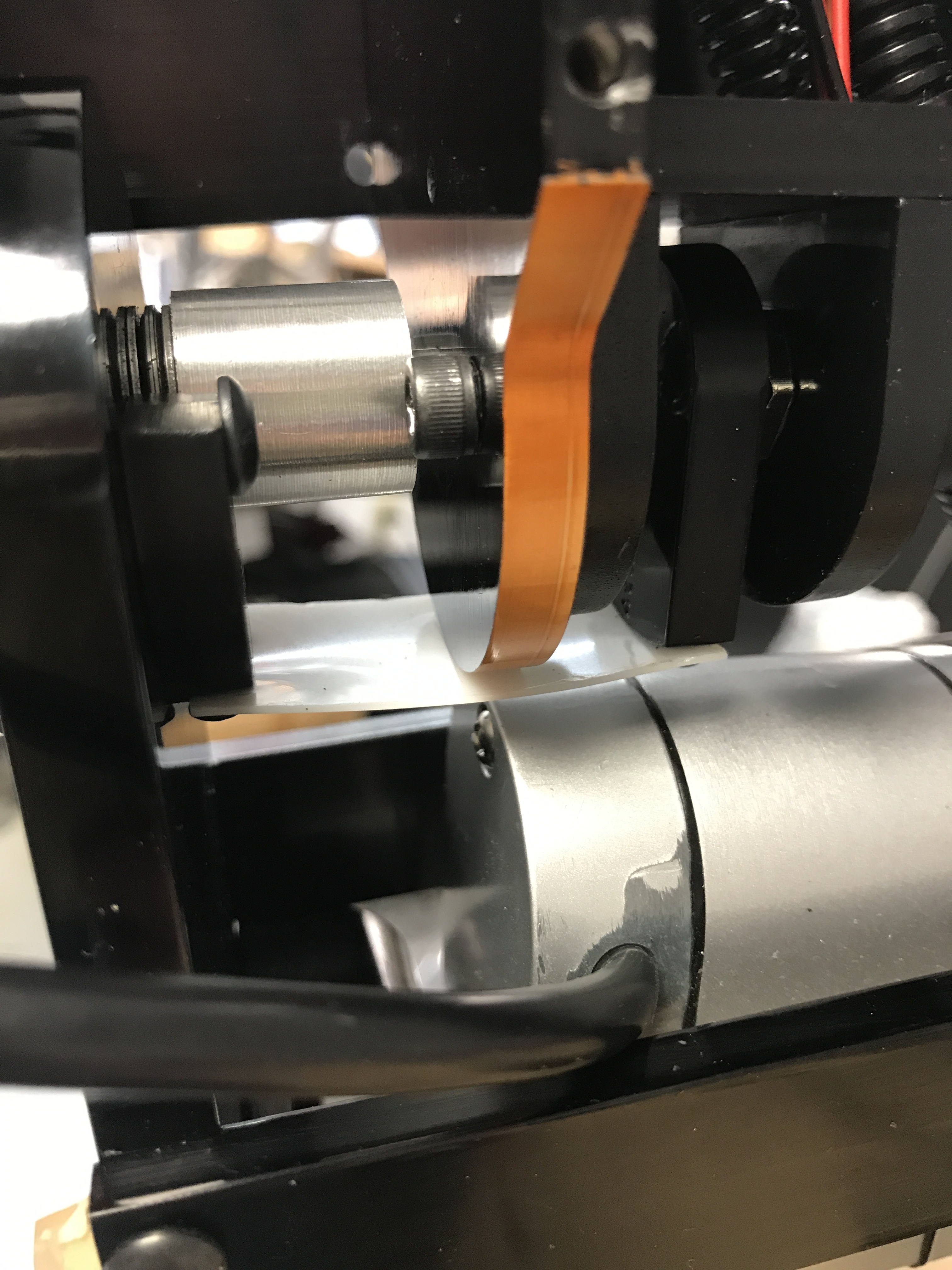

  • Spent the day making up CAD drawings and then modifying them. I downloaded the CAD files to the laser and cut all the parts out of delrin plastic. This cuts great with the 100watt laser and makes surprisingly accurate cuts. I have to take the kerf into account but that tends to be fairly consistent.
    I got up to the mark III version and this one works! Still have modify a couple of the parts but the version I installed is working.
    This is a view of the new coxa encoder assembly with the leg partially disassembled. You can see the encoder and the delrin part that fits over the encoder shaft. This is bolted to the leg mount and is stationary. At the other end of that part is a piece of thin white delrin that connects to the movable portion of the leg
    This photo shows the connection of the white delrin to another delrin piece that is bolted to the movable leg.1A0AA608-8B4C-4BC8-B60C-829B99289267.jpeg
    Here the leg has been put back together and installed. I used the thin white delrin piece so it can follow the curve of the leg mount (the gold highlighted part in the middle). As the leg rotates on the coxa axis, the movement is directly transferred to the encoder. I quickly verified the calibration and the leg was moving well with no oscillations for the quick test. A check of the output from the leg didn’t show the symptoms that I was seeing earlier. So right now I’m thinking this idea is a success, only have to make 5 more! I will be lengthening the size of the part that fits over the shaft as I don’t want the white delrin part rubbing on the mounting.
    Tomorrow will be time for more testing to make sure there are no surprises. So I will run some of tests to swing the leg back and forth several times to see if any part loosens while under load. Then back to more testing of the IK routines!
    Bob

    The last 2 days were spent working on the coxa encoder mounting upgrades. These are the 6 parts that go into the encoder mounting bracket.
    The 3 parts on the left attach to the shaft of the encoder and to the movable portion of the leg. The white plastic piece connects the other 2 parts together. The 3 parts on the right are what the encoder body is mounted to and then it mounts to the robot base.
    Here is the stacks of the laser-cut parts ready to go. Actually there was a fair amount of finish work to do at this point. When the laser cuts it vaporizes the material, if the laser is moving slowly in order to cut through the entire piece the upper portion of the cut tends to get wider than the bottom. So there is a bit of an angled cut that needed to be sanded flat on parts that need to be screwed together at right angles. Next was drilling out the holes for tapping, the laser cut small diameter holes to help guide the drill for holes that needed tapped. Holes not being tapped were cut to size by the laser. All the legs had to come off the robot base, again! I had to come up with specific assembly order for the new parts since the installation area is fairly tight and some screws become inaccessible at one point.
    After re-attaching the legs again it was back to calibrating the coxa routine again for each leg. I’ve gotten pretty good at it now and it only takes 3-4 tries to get the upper and lower encoder values.
    When I left the workshop the battery is being recharged and everything is ready to get back to working with the IK routines tomorrow! We are getting ready to start some house renovations so I’ve got to get as much done as I can before that starts, don’t know how much time I’ll have available during that process!?!
