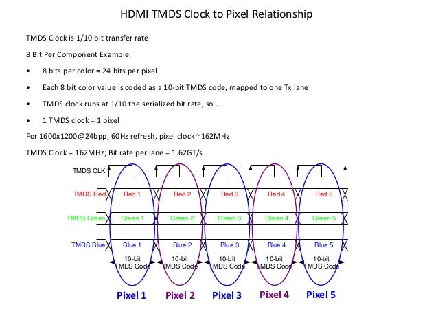

It seems to be working on the FPGA, but I now realize it's too slow to test, as the FPGA only goes to 80MHz.
Does anyone know of a data-to-TMDS translator program that lets you check the output of a TMDS encoder?

Does anyone know if the Clock+/- has any relative timing requirement in relation to the data? It cycles at 1/10th the Red/Green/Blue bit rate.

    I think the clock fronts are aligned with the 10-bit packets, see:
    https://image.slidesharecdn.com/hdmivijaychachara152-140526050115-phpapp02/95/hdmi-15-638.jpg?cb=1401082522

    Been searching for a precalculated LUT, but couldn't find one :neutral:
    Checked a dozen or so papers on TMDS and there is no mention of any required phase relationship between the data and clock, although all the diagrams look similar to what Antoine linked to. Did see data rates of 10 x clock and 14 x clock mentioned so it looks like it is there for a PLL to lock on to and sync to the data bits.

    Thanks for the links, Guys. I will make the clock start high. Right now, it's starting low.
