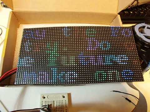

  • I bought 32x64LED-matrix(size:192×96mm, LED pitch:3mm).
  • Displaying string on 32x64LED-matrix.
