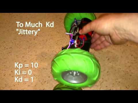

    Another good PID demo.
  • ercoerco Posts: 20,255
    Everything's better with an Aussie accent. I like this guy, same mannerisms as Dave on EEBlog.
    An excellent PID demo. Just what I had in mind.
