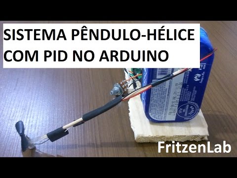

I was thinking of controlling the angle of a paddle blown by a fan

Positioning a paddle position controlled by a fan has the same issues. But a pivoting beam whose position is controlled by a fan at each end sounds like a winner. Like a one dimension quad copter. THat might appeal to students. A balancing bot with two arms with fans at the ends.

A servo - that is a simple demo as well... Hmmm. Now the question is can I build a demo before we get there in the lectures? We use PID in the lab to control some hydraulic rams, but not wanting to introduce all of that complication to them. (See photo)
