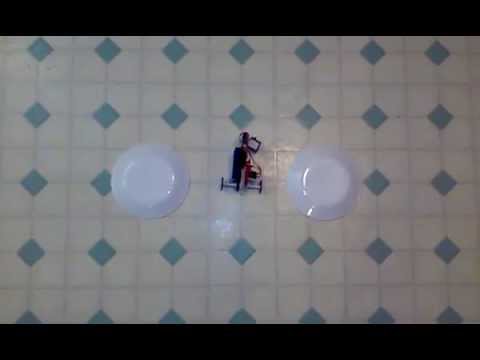

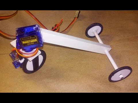

    Here is today's uber-simple bot, an ugly but quite functional duckling. We're probably going to 3D print an improved version of this chassis to use in a robot camp. Two 9g servos, one continuous rotation drives, one steers. And a 1 PPR mechanical encoder. Easy peezy, works every time. Just have to calibrate servo turning radius to match up to a 360 degree turn with an integer multiple of my wheel circumference. In this case, 12 wheel revolutions per circle. Accelerates & decelerates. First test was this figure 8 course. Bot will soon have IR and ultrasonic sensors and audio output. Maybe light tracking too.
    Video thumbnail shows bare chassis before the electronics were added. So hideous that it's beautiful.

    Nicely done. Love the rear wheels and tires.
  • ercoerco Posts: 20,224
    edited 2015-03-19 08:39
    All my wheels are hacked out of thin sheet styrene, hand-turned on a shaft against a belt sander. Rubber band tire is a slit of road bike innertube stretched around the disk. Crude, quick, works great!
    edited 2015-03-19 09:11
    No glue on the rubber? I guess if you cut it short enough to stretch, it will hold.
    Looks nice man.

    Videos show wheel encoder (Oh Mr. Demille, I'm ready for my closeup) and bare chassis with both servos being driven by a servo tester in oscillate mode. A random pattern, but delightfully fluid.

    Excellent feedback, Rick! Come on in, the water's fine... Here's a table top-sized figure 8 for my presentation today. Didn't even use the encoder, it's quick & easy to use timing commands and calibrate for consistent 90 degree turns. This simple little trike bot is actually a lot of fun to use.
    edited 2015-03-19 11:38
    It's fun to watch! I really like how well the outside rear wheel sticks on a turn. It looks like your success with accuracy comes from how well you have center of the front wheel aligned with the center of the pivot attaching it to the body.

    IMO the best thing is that you can go straight just by steering the servo to a certain location. You don't have to monitor two wheel/motor encoders and synchronize wheels as required by differential steering. Freedom at last!
