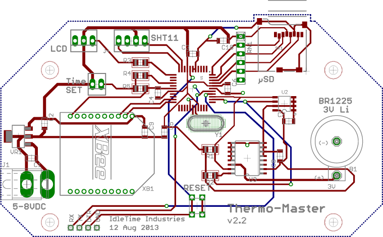

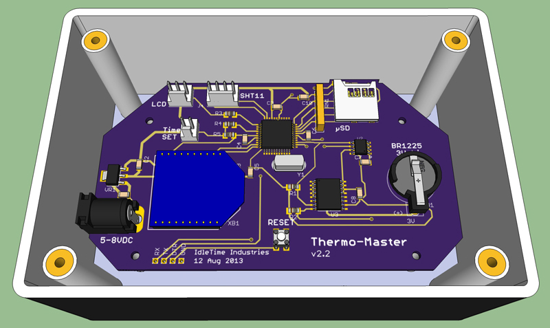

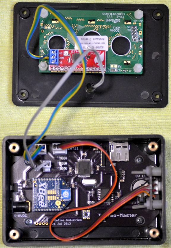

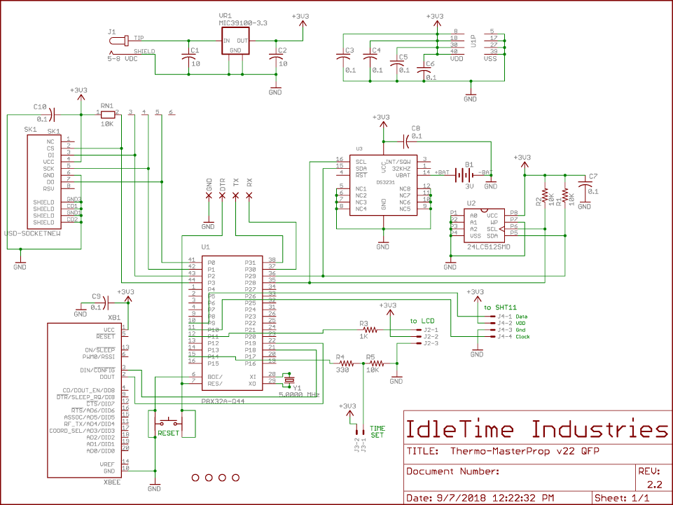

  • JLockeJLocke Posts: 354
    edited 2018-09-07 19:54
    I reworked the hardware for the master unit, moving to all surface mount parts. I moved the SHT11 off onto its own small board; it's mounted in the side of the box now.
    Thermo-MasterProp v22.zip Thermo-MasterProp v22 Gerbers.zip

    Jim, Your picture in the Tachyon thread made me go back and look at John's old threads to see if he had one on that proto board. I didn't get too far, but I found this:
    http://idletime.com/PropBreadboard.html
    Good luck with that RTC.
  • The Propeller Breadboard module is documented on my Web site here: http://www.idletime.com/PropBreadboard.html
    I've got the full data logger documented there, as well: http://www.idletime.com/Thermo-Prop.html
  • Publison,
    That is the exact board that I have. Thanks for the schematic on the board. It will help me trouble shoot the dead one. RTC is running well now that I have cleaned up the wiring and properly installed the pullups.
    Jim
