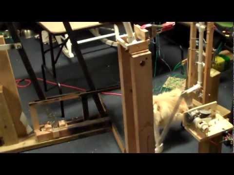

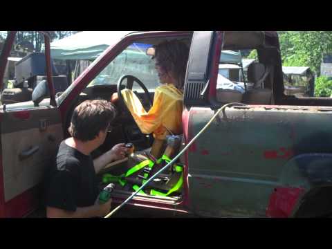

    Created a new rig for the head banger prop because the
    head's weight made it too hard for the motor to pull it
    back up with the pivot point down at the base. So I moved
    the pivot point higher and counter balanced the rig with a
    spring that helps pull the head back up.

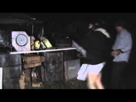

    Another Halloween prop. I had to cut two of the six I had planned on with time running out. Hood guy (zombie torso) was so close but I couldn't get
    the motor/angle/rig/weight worked out right to make it reliable. Microwave spider was going to be another cool one, but the motor was not up
    to the task. This attacking spider prop makes use of the other props anyway and it moves really fast.
    [video=youtube_share;Rp1LRhT9O8o]

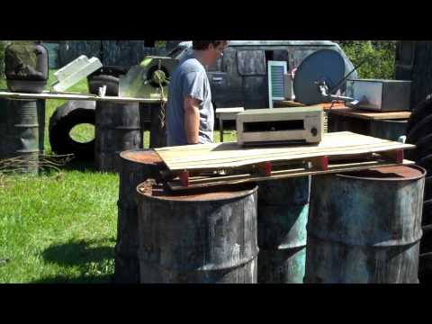

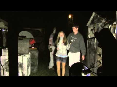

    A walk-through of the Junk Yard. I greatly underestimated the amount of
    wire I would need so everything got moved closer to the control box.
    [video=youtube_share;Goj9cPE2AoY]

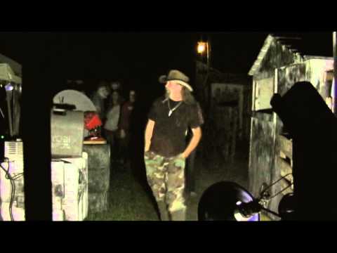

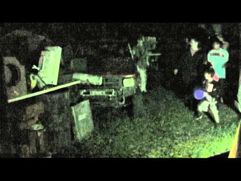

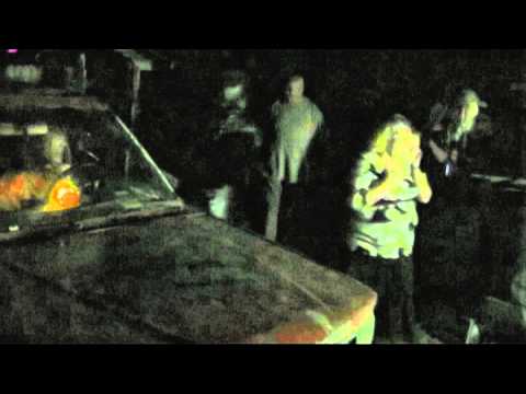

    Not a great first weekend. For some reason, the wall warts just keep burning out. They move
    the drill motors a couple of times then stop passing electricity. Wasn't having the problem at home
    but can't imagine running off generators would burn them out. Doggie was the only one I could
    get moving using a car battery charger for power.
    [video=youtube_share;3R1sU3QWw4o]
    This is doggie's view. He is to the left of the camera. Spider had to be hand operated.

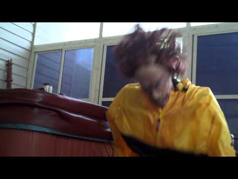

    Messed up this video by putting camera and light too far away, but still can see head banger
    in action.
    [video=youtube_share;x_Z2897nmQQ]
