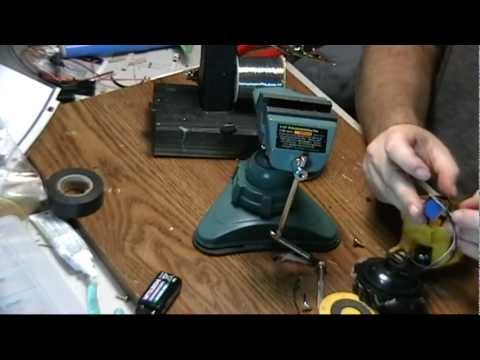

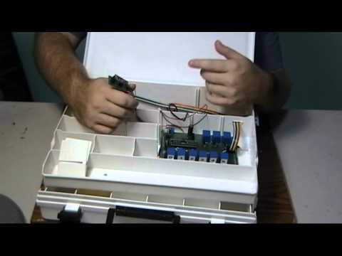

    Thank you. If this year, I can feel confident everything is ready to go a week before the first night, that would be a win. Past years haven't had that comfort level.
    This next video focuses on using relays to control motors and how I am progressing on automating the polecat.
  • RagtopRagtop Posts: 406
    edited 2012-05-30 11:25
    This is the relay wiring graphic from the video.
    1024 x 576 - 30K

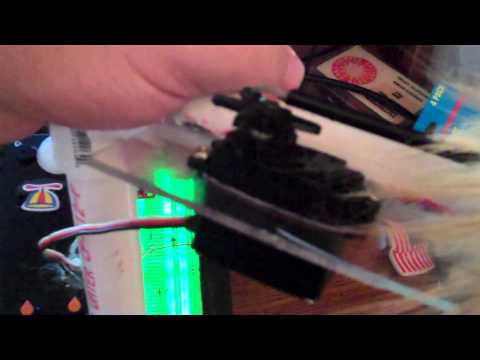

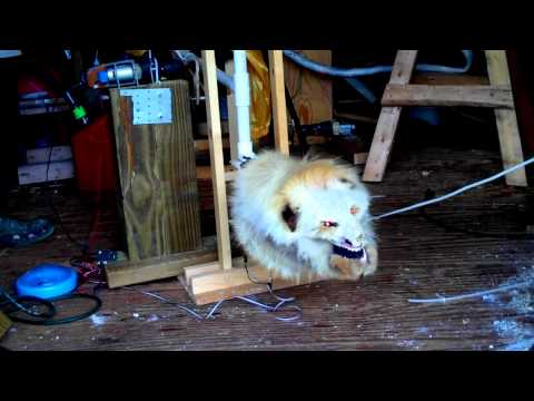

    I have been less then impressed with the speed and power of servo's ......at least the servo's that I can afford.
    Thinking maybe a small swing arm motor. Yep, I am truely a one trick pony.
    I thought it would perform better with this small jaw. The servo was originally for the doggies jaw but I had to move up to a bigger servo.
    I have a spring in the jaw to help close it when I was doing it by hand. Might
    try it without the spring before moving to another motor.
    edited 2012-06-03 13:03
    Even so, I think the jaw action looks pretty good. Remember it'll be dark, with spooky lighting and (I'm guessing) sound effects. The audience really won't be staring at the dog's jaw opening and closing, especially if you put those red LEDs in its eyes. Shiver!!
    -- Gordon
    edited 2012-06-04 05:14
    I was hoping for three or four chomps each time the head swings out.
    For sound effects I am using a MP3 trigger board. Each monster has their own sound and this year
    I am going to build a speaker control system that I didn't get around to last year that routes each sound
    to the monster's speaker.
    Last year I ended up using a home theater sound system and piping the sound out to all speakers.
    edited 2012-06-05 11:47
    Feeling like a doofus. I was using single servo spin and shorting the waitcnt at the end trying to get more speed....keeping the first waitcnt at one second. I didn't see it there, I guess.
    repeat
        position:=100                     'Start sending 1ms servo signal high pulses (100 * 10us = 1ms)
        waitcnt(clkfreq/6+cnt)                'Wait for 1 second (1ms high pulses continue to be generated by the other cog)
        position:=30                'Start sending 1.38ms servo signal high pulses (Center position)
        waitcnt(clkfreq/6+cnt)                'Wait for 1 second (1.38ms high pulses continue to be generated by the other cog)
    Now she chomps pretty good. Can't make the waitcnt any shorter as it never gets to it's full open and close position before turning around.

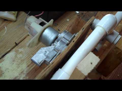

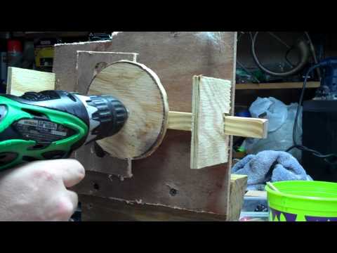

    Been playing around with this other method for getting linear action out of a motor.
    Hard to tell without a load, but it might be more efficient then the swing arm
    at popping out my Halloween props.
    [video=youtube_share;DChPB0ZeDPQ]

    Using 3dstudiomax to try and figure out how to make a metal rod and ball bearing version of this new linear action gear.
    800 x 600 - 88K
    800 x 600 - 85K
    edited 2012-07-24 11:29
    Strange, this morning putting up dishes I noticed the basket rail in the dishwasher and thought that might work.
    Currently, though I am thinking about making a shuttle on two bars similiar to Ben Heck's heat element shuttle on his 3d printer.
    [video=youtube_share;xJndXebTG9I]
    It would give me a sturdy platform to mount a push rod on one side and the channel for the "orbital bit" on the other.

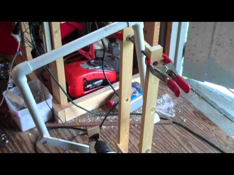

    edited 2012-08-24 09:32
    Not where I was hoping to be at by this time as I seemed to be out the whole month of July with a summer flu.
    I do have a working speaker control system but still no sound. By old mp3 board gave out and I can't get a new one
    to work. I am thinking about just going with Agyeman' wav player object and an sd card.
    Found out something simple to most folks but myself. By adding weight to counterbalance the weight of my
    monster hanging from a pivot point, my motor has to work a lot less to move it as it floats at the mid-point so pole cat
    moves faster.
    [video=youtube_share;G7XJnjVWlKc]

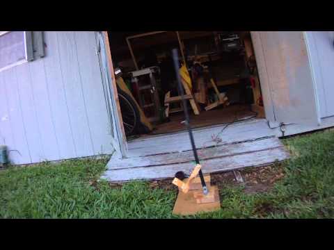

    edited 2012-09-04 06:12
    This is version 2 of the hoodguy Zombie torso. He will be laying face down
    on the hood of a junk car like he went through the windshield and got cut
    in half. Then suddenly he will rise up on his arms when the trail goers come by.
    [video=youtube_share;KAPYzahhjUQ]

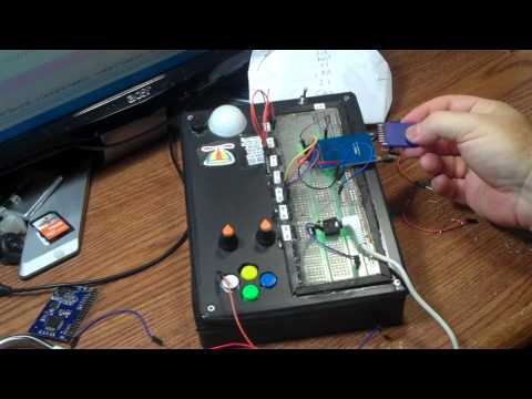

    edited 2012-09-12 10:26
    I got my new SD card adapters in and started to play with Kye's KISS Wav player to use to
    give my monsters their voices.
    I am getting a bit of hum in the audio. I tried the circuit included in the object. Then I tried a more
    involved one I was planning on using between MP3 player and stereo system. And I tried a op-amp
    low pass filter I found somewhere. I know even less about audio then the little I know of electronics.
    Maybe I am thinking it is a low end noise when it really is high pitched? Tone death I am.

  • GeeksGoneBadGeeksGoneBad Posts: 100
    edited 2012-09-12 10:59
    You know more about this stuff than I do ;)
    did you actually use an LM358 like the schematic or did you substitute some other opamp?
    I googled it and one guy said the LM358 wasn't so great for audio - are there maybe better opamps for audio?
    edited 2012-09-12 11:53
    Yeah. The LM358 is the only opamp I have. Don't even remember what project I originally got it for.
