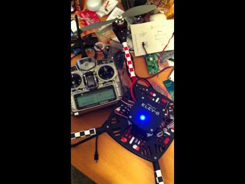

    It flies! I've successfully ported the QuadX flight code to the HoverFly Sport board, adjusted all the pin configs, and added an arm / disarm sequence like the Sport. It's pretty stable, but I still need to tune the PIDs for the new frame / motor config and some changes I made.
    It's too dark to shoot video outside, but I thought I'd have a little fun with it in the meantime:
    Listen carefully - you should recognize the tune.

    I have the Elev-8 / HoverFly Sport flying reasonably well. Mine isn't as stable as the Sport board, but it's close, and still needs tuning.
    I haven't balanced the props or anything, so there's some vibration, but the Sport board doesn't seem to care - HoverFly's code is very stable and does a remarkable job of filtering out noise, so they're earning their paychecks. :)
    I have a number of ideas for things to try to improve it, but I'll probably just get the current code tuned as well as I can and release it so other people can start tinkering with it.
