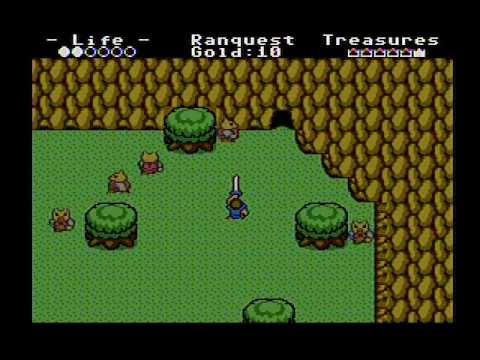

    Here is what the game looked like last year. It is a Zelda like game.
    I will take some new screen grabs after the game is uploaded.
    512 x 384 - 13K

    The SN76489 is probably the simplest commercial available PSG ever created, that's one of the reasons for SNEcog being so small (476 bytes).
    Wow, that screenshoot looks great.
