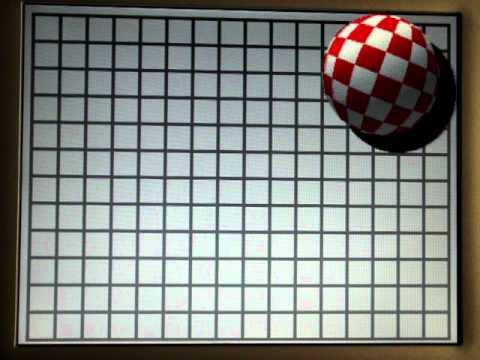

Below are some video demos of the Propeller driving the Gameduino's various functions. These videos aren't really any different than the ones already on YouTube. They only serve to prove.
GD_BoingBall.spin: This is the famous bouncing ball demo. You can see it's a little slower than the Arduino version, but I'm confident that could be sped up with a little work on the demo code.
