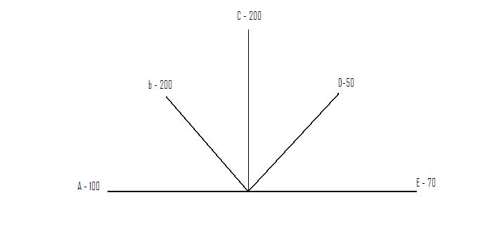

If I sweep the head on the bot from right (A) to left (E) and get the values (distance) from 5 specific spots during the sweep how am I to mathematically or logically determine the lowest number. (low number means safe to travel in that direction)
I have an array I am tweaking with but so many if then statements it is out of control.

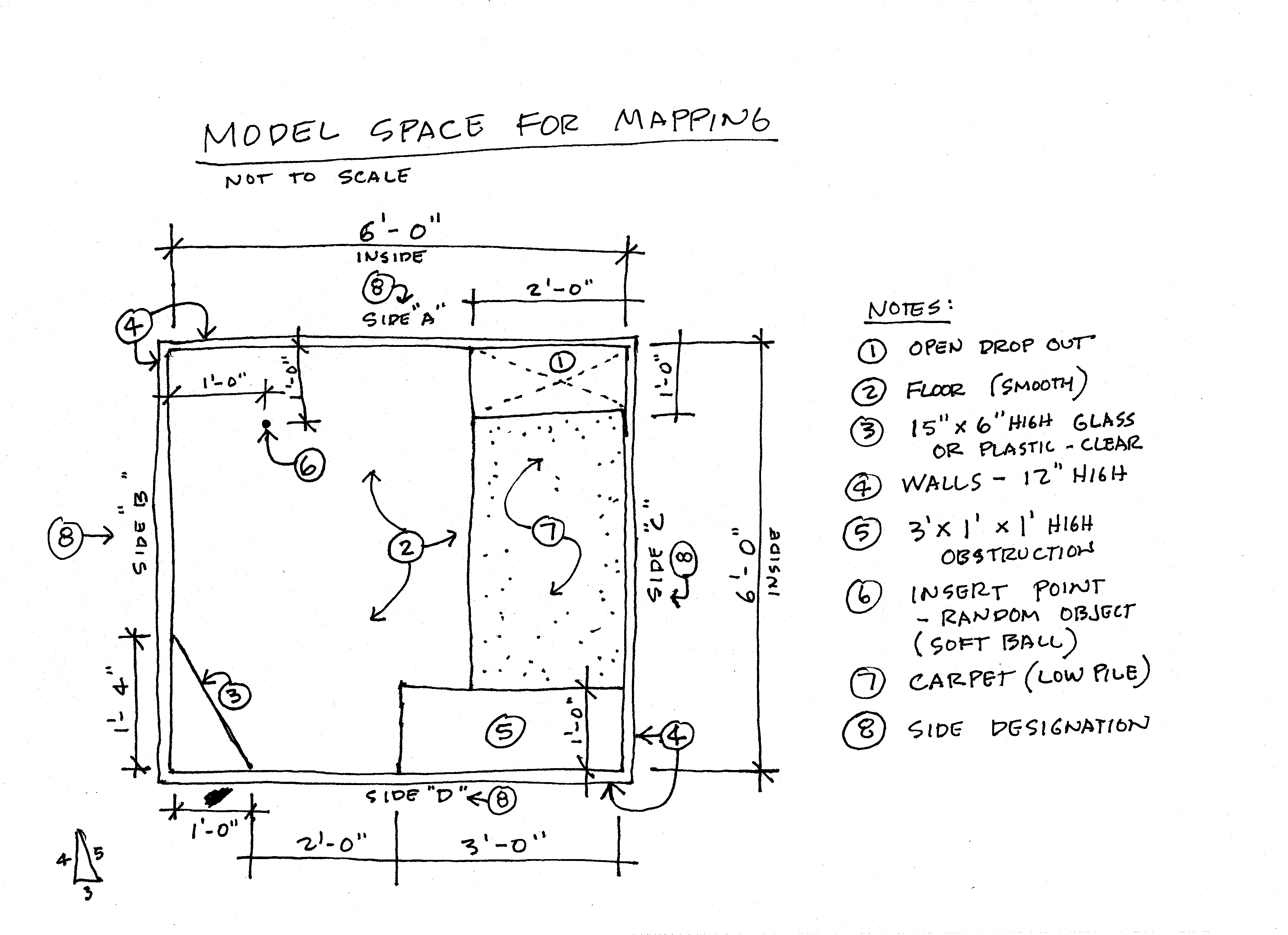

I just sketched this Model Space idea. After reading DG's post it may be too small, but I didn't want to make something so big that everyone couldn't use it. It is attched.
Some points -·A hole in the floor seemed a good test condition (open stairs down etc). I put in a simulated window (like a sliding glass door - would some sensors be oblivous to this - especially with a hard surface just behind it?). I have hard and carpeted flooring. I have one obect in a corner and an insertion point for the "ramdom object" - I suggest a softball. I did not know how high to make the walls. I know some of you have pan an tilt heads - would you map above objects or just to the objects in the bot path of travel - or might you "landmark" off tall or unusually shaped larger objects in an enviornment?
Lastly, I gave designations to each side so that we could converse about the space more easliy.
Let me know if this helps or is even something we think we need. I can refine it in whatever way we might think best.

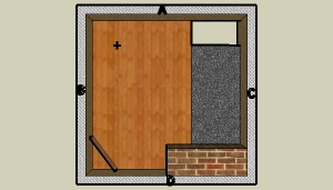

Here is the model in Sketchup. this does bring up a point. scale could be an issue. I don't really seeing it be a huge obstacle but definitely something to consider. I choose a 1'x1' grid in my thoughts about this. but that may be to coarse for a Boe bot, or too fine for a larger bot. the smaller the squares the more data but higher accuracy. anyway here is the model.
SkyWalker, this was mentioned in a similar thread. but it's good info and I'm not sure if you've seen it.
DG,
Nice sketch! The software is unbelievable. I will play with it more later. Thanks for the tip. I'll get back to you on the scale questions.

I'm not sure I fully understand where you are heading with the "Space Model"
Let me try to explain what I get out of it, please comment.
Basically the Space Model is the static map. In the drawing that Whit made, there is a new element to the map which
we didn't discuss before: the floor coverage.
Agreed that this might impact the performance of the bot but may I suggest that we leave that variable out the
equation. (for the time being) We have to rely heavily on the performance of the odometers. If we can't, the logic is down the drain.
Once we have a very good functioning level 3+ system, we might be able to deal with the floor issue.
Now suppose we all have the (same) map to start with. In the example there is a space of 6'x6'defined.
I assume that we then reserve a similar space of 6'x6' in the real world and let the robot operate in that environment.
Of course, there are no walls and there is no hole in the floor but the bot should move around as if these elements exist.
What is tested is this set-up is the accuracy of the positioning systems based on the odometers and compass.
Other sensors do not contribute to the navigation.
Characteristics such as a glass wall or a window and the height of the walls are not relevant.
The next step is to add well defined objects at defined coordinates within the 6'x6' world.
The bot should be able to detect the objects and update the dynamic map.
Since we all use the same mapping system and hopefully similar or identical bot operating software,
the differences between the behaviour of the bots is a result of the mechanical differences.
Actually Ed I was proposing that we each build a small test enviornment. It would not have to be overly compicated and maybe my idea is. I was thinking that a standardized space might let us all work together more easily than each one mapping a space in their own house or apartment. Your idea of a "virtual static map" in which the bot moved·is interesting. If the bot believed it was in such a space, we could see how it did? This might be step one in this journey.
But, if we also need direction measurements (compass), and want to rely on Ping and IR sensors and encoders - we need to move toward talking and incorporating their input (the dynamic mapping) and integrating/confirming with the static map. I thought that might be the purpose of a standardized test enviornment. (It occured to me that we would have to have the enviornment oriented the same compass direction, if we·are using a compass).
As far as the floor type, I agree we might best start with a smooth floor. I still like the idea of a hole in the floor, but this could be dealt with later also (I was thinking that the test enviornment would be on blocks with the hole in the floor as an obstacle). The same is true of Glass openings. Floor surface changes, low glass openings (sliding Glass doors) and the possiblity of heading off a cliff (so to speak) or down a set of stairs are so common in the real world, that they will need to be addressed - but these could all be done later.
For simplicity, we could use a 6' X 6' - 12" high box of plywood. It could be just 4 sides and set on any hard surface we have. We could orient it in a similar direction by compass. We could aggree on one standardized obstacle placed wherever we wanted. This would allow us to make a standardized static map, plus still have the bot taking readings within the space itself.
Later we could add the complexity of different floor types, unknown drop offs, glass (ping would catch this, but would IR?) and movable changes in the space.
Hope this clarifies my proposal. I will take the lead from you guys (I have no Prop experience and may not have one for a bit). Happy to help in any way.

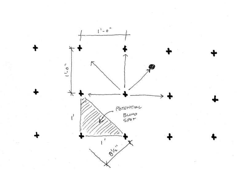

I didn't have too much free time last night but I was going to build a numerical map representing that space so we could define a stander ranking system for the grid. hazards, safe areas etc.
that's how I see the model being used.

As far, as having one every square foot or so -·I guess that would do it - wouldn't it?

I was pointed over to this post because I want to do the same thing with my bot that you all wish to do. I am working on wheel encoder’s next week and needed to get some input on the logic behind deciding what a better place to travel is. I am using an IR sensor and I can read from 2” to 3’. I need some help addressing this logic - how do I find the lowest number out of five numbers ( a low number means safer to travel towards). Take a look at the picture

Flood I'll PM you come code. I do exactly the thing your looking for you don't need to use an array you can calculate the highest as you go very easily. set your variable to 0, then as you turn your servo to each position you you say if new distance > than longest distance then new distance = longest distance. look at the code if that doesn't make sense. also you need to check your center position last or your bot will always turn when all. I'm working on some code that uses the compass to get the directions I'll post it when I get it finished.

I finally made some nice code that allows the robot to decide from 5 angles and 5 thresholds as to witch is the most likely to be obstacle free. I tried to use the code examples you all sent me but I am hard headed and needed to figure this out.
Here it is:
Did I get it right?
