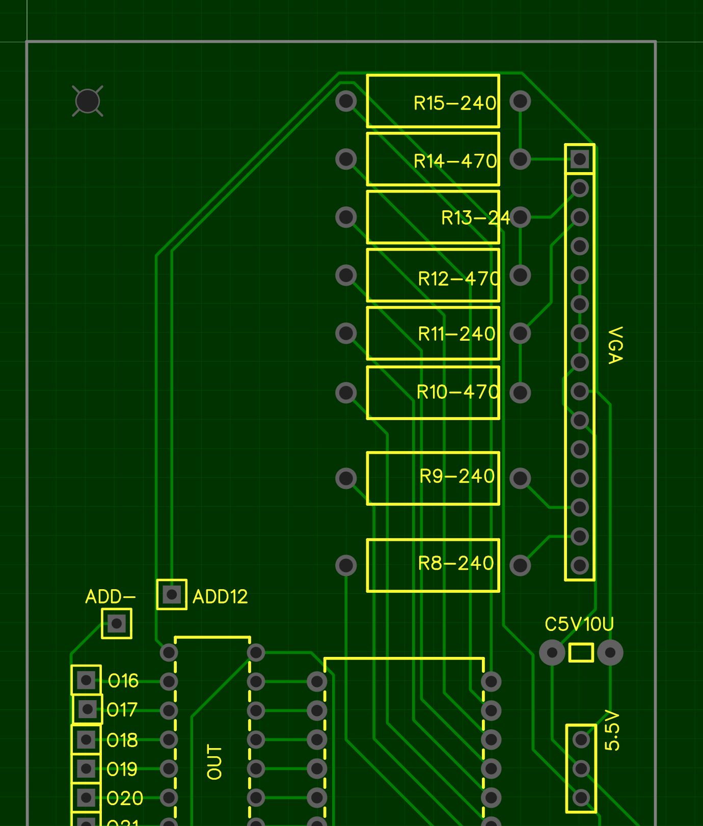

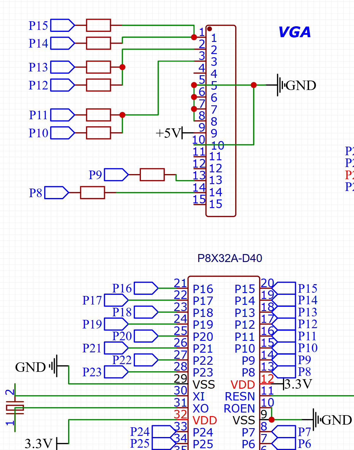

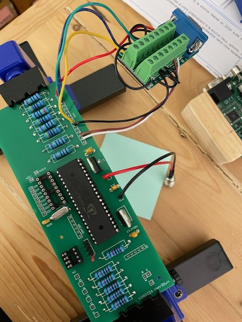

I'm building my own board based on the Propeller 1 and I can't get the VGA output to work. I think my schematic and PCB are correct. The code, cable, and monitor work, tested with a commercial Propeller Parallax board. I don't have many tools available (no oscilloscope, for example). How can I find the problem? I could test the outputs one by one with a multimeter, but what values ​​should I expect? How do I test the sync?
The screen remains black.
**Thanks
  • RaymanRayman Posts: 16,461
    Can you post the code you are testing with?
    Schematic does look like might be correct…

  • You kind of need a scope or logic analyzer to investigate this electronically. A mere multimeter will do you no good, since it's the signal waveforms that matter. Though for this sort of thing, you don't need an expensive or modern one.
    Schematic looks OK, but have you hooked up that breakout correctly?
    For a monitor to turn on (off of standby or a "no signal" message), the important signals are Hsync and Vsync only.

  • Stupid! Stupid! Stupid! I'm stupid!
    My code on my Pro card works because the VGA output pins are 16-23 and 8-15 on my card! Once I changed my code, it worked!!!
    Thanks
