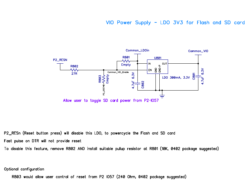

That might be a power loss on reset issue. Is this an Eval Board you're testing with? I've modified both my Eval Boards now to prevent a tiny brownout occurring with the EEPROM.
What I do is remove R802 and link R801 instead.
EDIT: PS: The fast pulse, on DTR toggle, is when the brownout occurs.
No, it's this board. +3.3V is powered from an 800mA LDO which is enabled all the time. I use a special isolated ProgPlug so I'm pretty sure there are no glitches caused by the DTR pulse. But the reset signal also goes to the Ethernet chip and could cause the oscillator to stop. That shouldn't do any harm if the bootloader is independant of the external clock and uses RCfast. But that's just my assumption which might not be true.
