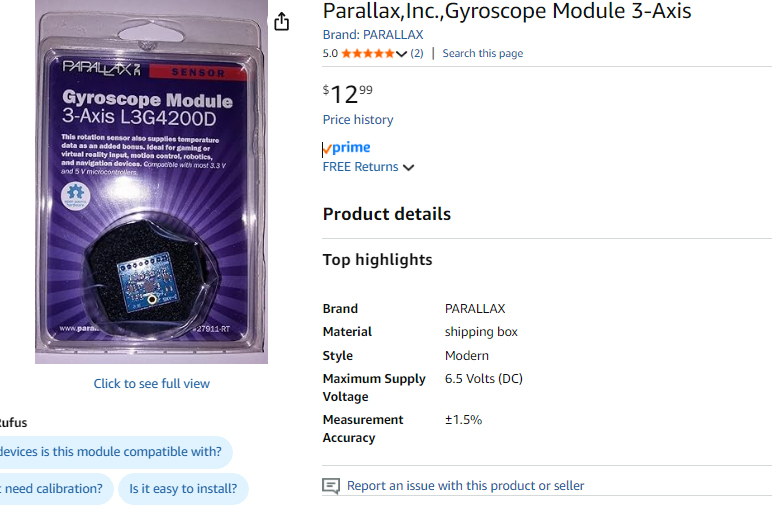

I am planning to use the Parallax Inc. 3-axis gyroscope for the balance system
