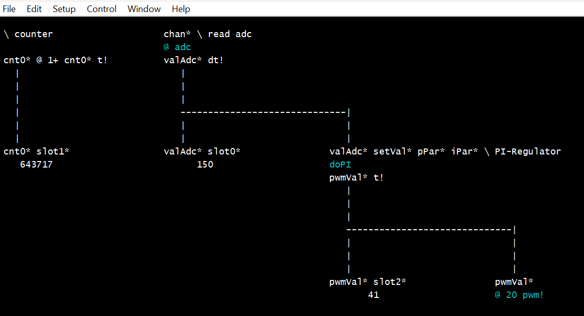

perhaps someone is interested to join into some discussion about graphical programming?
We have had such discussion in the past here and now I can share a little simple experiment.
I am sort of a "visually thinking guy", love for example topographic maps and like the concept of schematics. Also I like the concept of PureData for visual programming. All of them can give a fast overview very quickly.
On the other hand in my opinion any program language can describe a in detail sequence of steps in a much more compact way than a flow diagram.
So let me state some basic frame for my approach:
1. Use a programming language for the details
2. Use graphical representation for the big picture
3. Do not use "Sequence of operations" as lines like a flow chart, but use "flow of data" as lines like PureData
4. As a screen is never big enough, a concept for zooming in and out is needed. Modern good mapping programs have a concept of importance and select visible items corresponding to the zoom level. Also they use different symbols for the same thing in different zoom levels.
5. Like in PureData, the running code can insert life data into the graphical representation. So the picture becomes a user interface.
Some elements of the concepts of my experiment:
1. A new type of variable, which also has a time-tag. The idea is to use this, to decide which code has to run.
2. ASCII text is used together with VT control codes for cursor control.
3. A "node" has 3 lines: a) input variables, b) the code, c) output variables with some code
4. Use named global variables to hold data streaming from one node to several nodes.
5. The only database is a Forth source file. This means that the contents can be compiled with the normal compiler. The same file contains position information where to place the nodes. Or/and where to place the life data. To just view the graphics the file is interpreted by a special viewer.
6. Code of a node can be a sequence of any Forth words.
7. Instead of zooming there is the possibility to select different pages. (Much simpler)
8. Flow of data is always from top to bottom or from left to right.
9. Only selected global variables are drawn as lines.
10. All nodes sit in a big loop, if they are normal Forth words they are executed every cycle. Special new words can be defined, which can decide if they have to execute. Idea is to use the time-tags here. (???)
11. The loop is executed with "pause - type" multitasking in background, so the system remains fully accessible in parallel. You can alter parameters for example.
12. Special new store operators: t! store with time-tag. dt! store with time tag, if the new value is different from the previous.
13. I have the convention to use name* with a star at the end to indicate variables with time tags.
Well sorry, this is done with Forth. Reason is that it is very much simpler to do this with Forth. And Forth can recompile the test file within xx milliseconds.

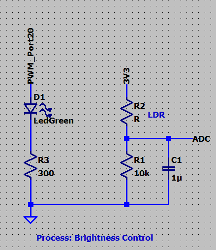

As little example a LED shines together with the ambiente light onto a LDR. A program shall measure brightness, use a PI-regulator and a PWM output to always have the same brightness. Additionally there is some software counter, which gives an indication of the speed of the loop.
Backslash indicates a comment. doPI is the PI-Regulator. graPrt does the life data output. So when running, this page looks like this:
At the moment there is only a viewer, not graphical editor. The graphical interpreter is also rather basic.
An experiment.
Comments? Suggestions?
Christof

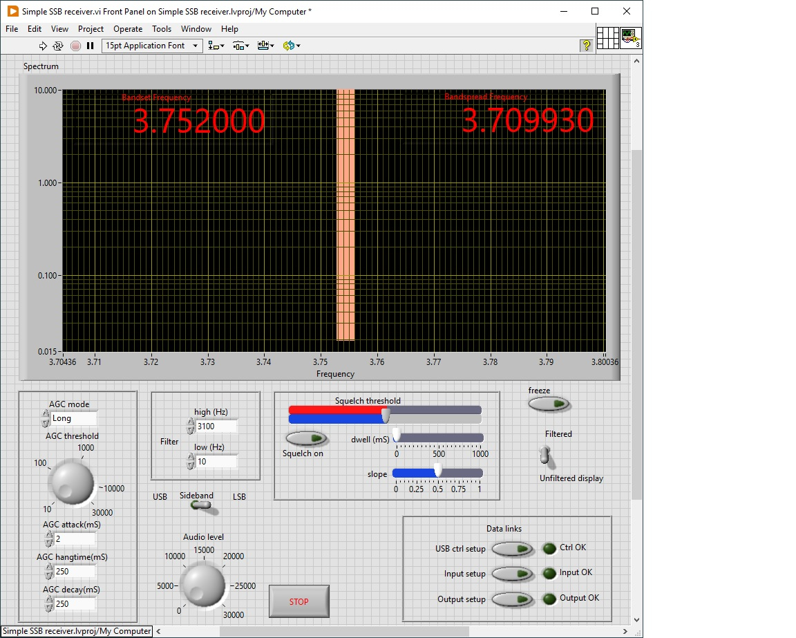

    I did in fact make a software defined short wave radio receiver in LabView. It works very well - very good audio. The radio frequency hardware I used emulated a USB soundcard, delivering a 96K stereo stream of received signals. This equated to a 96kHz chunk of the SW band, to be displayed in a panadapter and also filtered and demodulated by the PC to the speakers. I could receive anywhere in the 500kHz to 30MHz spectrum - and it didn't require a great deal of processing power on a modern PC.
    OK on the garden monitoring. LabView would make the graphs and meters for you and you would be surprised how simple they are to program. You can communicate with the remote sensors by serial port, bluetooth , tcp etc it's all available. There are hundreds of examples supplied, on which to base your application and plenty of YouTube tutorials out there.
