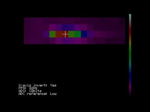

    Vid of the (simple) VGA P2 demo:
  • Thats a great little demo avsa
  • Thanks...I wish it had things like image interpolation, or most importantly, the aforementioned calculated offsets so it could display real temperatures rather than just "this pixel is warmer than that pixel", but it's a bit much for me, at my skill level. That's why I figured maybe if Ray is unable to find suitably licensed existing code to write his own driver, he could use this as a basis.
    Cheers
