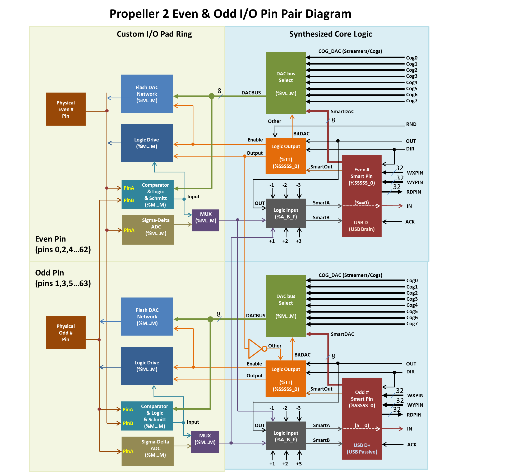

A friend reached out asking if I knew of a good diagram detailing the internals of the P2 Smart Pins. I have seen such diagrams mixed into various threads, but can't seem to find them now. My memory -- which could be faulty as I've been working long hours -- tells me that @evanh has produced nice diagrams. If I'm correct, I hope he'll copy them here so that they're easier to find for myself and others. Forgive me if I'm wrong about the diagram creator; whoever you are, your work is appreciated, and I hope you'll post that great work in this thread.
  • https://p2docs.github.io/pin.html#diagram
    Don't remember who originally made that.
    Though @ikskuh at some point wanted to make a nicer SVG version, I recall, but IDK where that idea went.
  • RaymanRayman Posts: 16,402
    Yeah, that was me. Based on @evanh text based drawing, as recall...

    Copies from Ada's docs:
    Copied from Evan's link.
