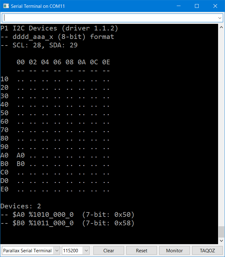

  • JonnyMacJonnyMac Posts: 9,821
    edited 2025-08-16 14:08
    The example code (other languages) I could find defined the address $40, but they must have shifted the bits elsewhere.
    You'll see this in Arduino-compatible code. Internally, their library shifts that left by one bit to make space for R/W.
     * Function twi_slaveInit
     * Desc     sets slave address and enables interrupt
     * Input    none
     * Output   none
    void twi_setAddress(uint8_t address)
      // set twi slave address (skip over TWGCE bit)
      TWAR = address << 1;
    The first I2C component I ever worked with (long before the Arduino was around) was an EEPROM and its datasheet showed the full 8 bits (including RW) of the device ID, so I've always used that style in my code. In my Spin I2C scanner I show detected devices in 8- and 7-bit modes to help myself and others when looking at examples from elsewhere.
