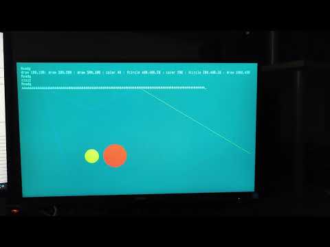

    edited 2023-07-26 14:54
    First program run.
    The line, after it is entered, is precompiled to the reverse Polish notation style. Then the result and the line itself is written to PSRAM.
    The result is an array of tokens. These tokens are indexes to a function table. Some of them contains also a parameter
    "run" starts from PSRAM address #0, reads the precompiled line to the buffer in the HUB RAM, then executes it. The execution is done like this:

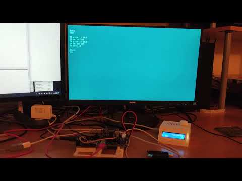

  • pik33pik33 Posts: 2,417
    edited 2023-07-27 14:44
    The retromachine type Basic has to allow to inserting lines into the existing code via their line numbers, so they are listed and executed in the order determined by these line numbers and not in the order in which they are entered.
    That was not very easy to do: I had to implement a 2-way list so every line has pointers to previous and next one.
    Now it partially works. There are 2 procedures that compile the line, one compiling the command (eg. print) and another compiling the assigning to a variable. The second one has to be upgraded by the Copy-Paste method :)
    The list allows positions of lines in the memory to not change. That enables to determine the line address for goto at the interpret/compile time, so the goto itself will go fast while the program runs.
    The way it is done now causes a memory leak when the line is replaced by the new line with the same number. In the future I have to do a memory manager to avoid this, but at this pre-alpha stage let it leaks, I have 8 or 32 MB of it. The screen was taken when the program was running on Eval with 4-bit PSRAM.

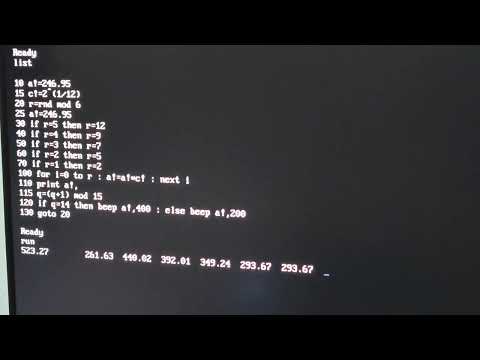

    edited 2023-07-31 13:48

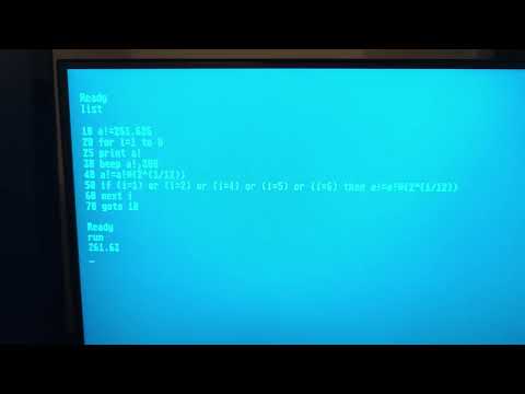

    First run with rnd and (unfinished) goto (that can only go to the line that is already in the program, the rest of cases are yet to implement) . Running on Eval+4bit PSRAM.
    Edit: i cannot play these video clips I placed here on the forum, except "play in YouTube". Do you have the same problem with these clips? What may I do wrong?
  • Plays perfectly, right here in the thread :+1:
    This is looking fantastic :)
    Will this BASIC be limited to retro-games or will it be able to drive I/O and trigger compiled code in other cogs, etc.?
    Craig

    At the end of the day I added waitms and pinwrite to the command list so blinking the led is now possible:
    10 pinwrite 38,0
    20 waitms 500
    30 pinwrite 38,1
    40 waitms 500
    50 goto 10
    ... also added waitvbl....
