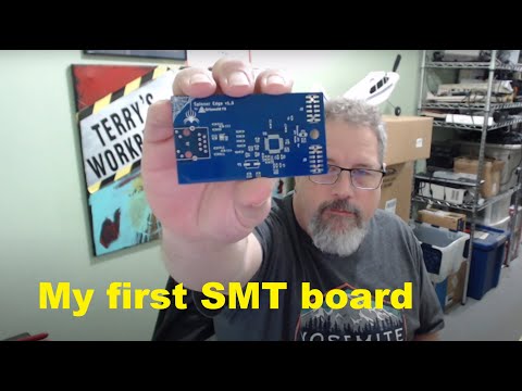

So I decided to make an attempt at a standalone Ethernet board based on the Wiznet W6100L. I had to jump through hoops so that the pins align with my light controller board. That's why tracks do not take the shortest path. This is also my first project in KiCad.
Please throw rocks at it, as I have limited experience with board layout. I don't feel good about all of the vias, but that seems to be the most practical way to cross traces.

  • You need a big notch between the pin headers to properly clear the ground posts. See Ray's RAM expander:
    The official Parallax double boards have them, too, but I had the 96MB board image at hand to illustrate.
  • If you stick with the unplated hold to accommodate the ground posts, make sure it's big enough. The lugs on my Rev B and Rev C Eval boards are 0.145" (3.7mm) in diameter. The ground posts on the Edge breadboard are only 2.4mm.

    LOL, I was thinking about doing a Wiznet board too in my next group of PCBs, but haven't yet got to it (though mine would be SPI only with the W5500 most likely).
    Looking at all those P2 connector signals crossings, you might be better off swapping the pair of data and control pin signal groups around between the two 2x6 connectors as each group seems to line up with pins closer to the other connector vs the ones they are currently attached to. (EDIT: unless this was done to match your light controller board...?). Control signal order mapping is typically arbitrary from a software perspective (apart from address pins) so you should be able to route those quite cleanly. The data signal order could still require some layer swaps but it still might end up cleaner than what you have, so it's worth a look or a draft routing attempt to see if it helps. Also this side is a relatively low speed bus (14MB/s or so) and the layout there isn't really that critical vs the high speed Ethernet data side.
    Is your PCB intended for 100Mbps operation or 10Mbps? For 100Mbps Ethernet the high speed side would need to be able to send it's symbols reliably at 125MHz. The data sheets on the particular devices you are using may include layout guidelines which could be worth reading through. That small 10 pin IC you have used seems to mess up the signals a bit and cause more crossings which may not be ideal. I think these are ideally length matched diff pairs so you want to route them carefully if you want best performance. Fast Ethernet isn't going to be as critical as GbE but it's still reasonably fast.

    Also be careful along the board edges. You appear to have a via and traces on the right side fairly close to the cut edge. If you have spare room on the board you may want to shrink the total size to keep the trace lengths short where they are high speed and move the main QFP up a bit too to balance it a bit more on the board unless you have other constraints that affected this choice (you'd mentioned aligning pins with other boards....).

    @Wuerfel_21 and @JonnyMac I checked and the hole I have for the ground post is 3 MM. That's a little too close for comfort. I may have to revise the layout to support the Eval boards. Thanks for making me double check that!
    @rogloh Thanks for the thorough look and links to documentation. The U2 device is a RCLAMP3304NATCT used for ESD protection. It is used on the wiz610mj that I modeled my schematic from. My magnetic is the only thing different. After looking for more info as you suggested, I found another board that Wiznet built. It uses the exact magnetic that I chose and does not have the ESD chip. I can't find any documentation saying that the ESD is built into the RB1-125BAG1A magnetic. I think I should keep it. Not sure. This Wiznet device is limited to 10 and 100 Mbps. The transmission lines are less than 2 inches, which I think is best practice. Also the magnetics are also more than an inch away from the PHY, which I think is also best practice. I may try to lay them out differently, to keep them the same distances from each other. Not sure I can do it any better though.

    @ke4pjw Since you asked for feedback... I'm seeing a lot of empty space. Appears to be the board could be a lot smaller.
    Probably doesn't matter electrically though...

    Also, I think the Ethernet connector usual goes past the edge of the board. Might be some problems as shown above…

  • In addition to Ray's comments, I'm wondering if you're really going to use 0402s on a homebrew board. That's gutsy! :p
  • @Rayman I updated the board to give groundplane clearance the same as is on the WZ610MJ from Wiznet. I also shortened the board to allow the connector to hang off the edge of the board like the WZ610MJ. Yeah, I need to just bite the bullet and do some SMT layout and build those skills. I am sure this will be a disaster, LOL. Maybe it will work, we will find out! I am sure I could make better use of the space. The cost is the same either way.

  • So I was going by the metric codes. The 0603 metric is much smaller than the 0603 imperial. I assume you all referring to the imperial size? Is imperial what is typically referenced?

    0603s are manageable, but 0805s are much easier to deal with. I think the patterns you want to look at in KiCad are

  • OK, so I decided to just change the caps to 0603 (1608M) to match the resistors and inductors. I had additional schematic errors that needed to be corrected in both the schematic and the layout. I am not happy with all the vias. I think I just need to get over feeling about using the vias.
    Based on the tolerances of the fab, I am not seeing any errors that would indicate they can't produce the board. I should be receiving the magnetics and other components this evening. If the dry fitting works on my printouts, I will order a handful of boards.
    I added a spiderweb to the silkscreen as a homage to the P1 Spinneret.

    Does U2 have another package option ?
    0.5mm DFN/QFN parts can be a real pain to manage manually.
    Extended footprint fingers can help a little, but they are still best avoided, if possible.
