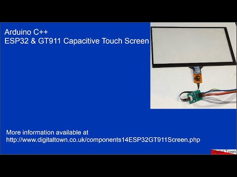

    This might be helpful...looks like there is some software done for Arduino which could likely be ported to SPIN2.
    http://www.digitaltown.co.uk/components14ESP32GT911Screen.php
    I'm somewhat interested in this too as I have a Waveshare LCD which I think may use the same Goodix controller (needs to be confirmed). It'd be nice to hack into that.

    Probably the HX6518 is just some customized microcontroller that adapts from I2C to USB. If the flat flex cable coming out of the LCD has a chip on it that one could be the GT911 and it will present its interface on the 6 pin cable. The simpler adapter board on that video I linked just shows direct connection to I2C and reset etc @3.3V. That's how the guy is getting access to the GT911.
    Update: just checked the Waveshare LCD I have and it does contain a GT911 :smile:
