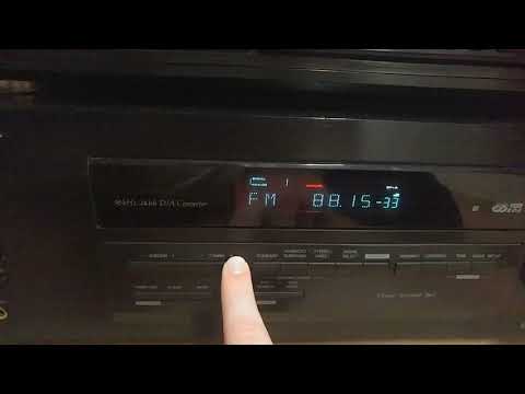

It turns out the chroma modulator is vaguely competent at generating an FM carrier wave.
I've included a version of OPNACog that has been modified for FM radio use, but the basic gist of it is:
  • the higher the clkfreq, the less distortion (in theory)
  • compute centerfreq := channel_in_hz frac clkfreq
  • compute bandfreq := (deviation_in_hz frac clkfreq)+/$8000 (assuming your internal samples are 16 bit)
  • enable some pin(s) in DAC channel mode P_DAC_75R_2V|P_OE|P_CHANNEL|(cog<<8)
  • setdacs ##$00_00_FF_01
  • setcmod #%11_1_000_0
  • setci ##$00_00_4D_80
  • in a timed loop (important, setcfrq applies immediately), do setcfrq with centerfreq + sample*bandfreq
  • the receiver will apply a simple one-pole low-pass filter. In my case, the signal was already lowpassed internaly, so I just disabled that to kinda counteract it. Making a proper pre-emphasis filter wouldn't be too difficult though.
Welcome to Kirisame FM 90.5 MHz, where we play love_coloured_magic.vgm, all day, every day.

  • Bothered to record a video demonstration.
    The reception would perhaps not be as affected by me touching the tx antenna if the receiver actually had any antenna connected (it's supposed to plug into a roof antenna or smth). It also works on my phone's FM receiver (suck it iSheep, my phone has IR, FM Radio, TWO HEADPHONE JACKS and an easily swappable battery)
