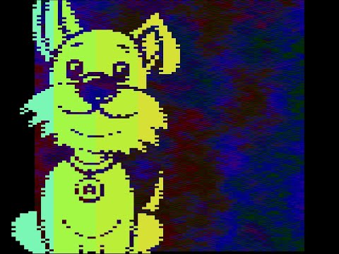

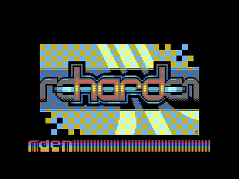

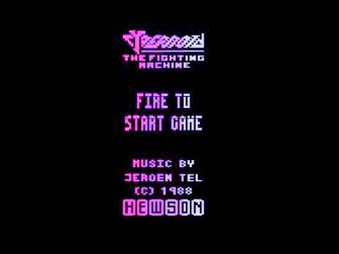

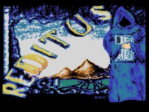

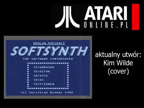

    Of course demosceners have a lot of tricks to do with Pokey. The example results:
    2 Pokeys:
