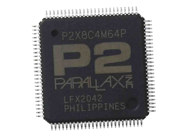

    Mouser Global product page for the P2X8C4M64P currently displays the following image:
    https://mouser.com/images/marketingid/2020/img/106066264.png?v=010421.0540
    which matches a non-ES, Rev. C silicon produced at Philippines during the year 2020, based on the marked lot code (LFX2042).
    Again (and for historical tracking of versions/lots), based on V35 docs (page 01), there were REV C chips (currently accepted as final) that yet shows the ES appended to the part ID, marked with lot code LHU2019. If they were Rev. B (ES), the lot code would show LPD1941.
    As usual, a fresh picture taken from the device you received, would help clarify things a litle bit. :smile:

    Thanks! No photo needed. My sample has the lot code you referred, exactly. It is LFX2042. So, I would assume it would be the 42th week of 2020?
    Edit: Released in October 2020?
