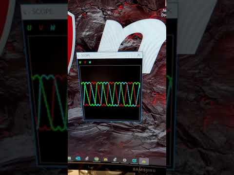

Today, Doug Pientak stopped by and I helped him with some code to drive a brushless DC motor. He had an algorithm he wanted to implement, aside from the regular 3-phase PWM, but I don't remember what it was called. We got it working, anyway. Now, he's going to try it on a hoverboard motor.
Here is the normal 3-phase output:
Here is the special algorithm added (not skipped over) that is supposed to work better for controlling motors between pole positions:
Here is the code:

Just heard from Doug. He said he attached a brushless DC motor from a model airplane and it turned super slowly.
Now, he's got it running the hoverboard motor, which was the goal.
Driving 3-phase motors with lightly tweaked waveforms is well-known. There's two possibilities here - The algorithm is trying to correct for torque ripple or, more likely, it's a wye-wound motor and he's letting the center tap float to improve voltage peaks across any given winding given fixed rails. Or both...
He is also going to want some kind of motor feedback - e.g. Hall sensors, an absolute encoder, or undriven phase monitoring to get the phases correct for any given motor speed. Looks like fun!
