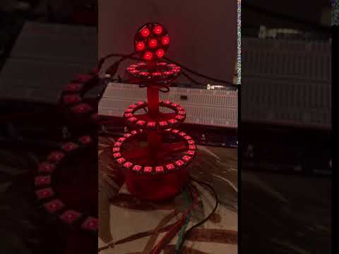

    Just an example of your code, running with some Adafruit NeoPixel rings, as a Christmas Tree: https://youtu.be/Vu4qSBq1EUU
    dgately
  • JonnyMacJonnyMac Posts: 9,809
    edited 2020-12-26 18:32
    Excellent! My friend, Matt, whom I mentioned in the presentation, make an animated tree-topper with Neopixel strips.
    I wrote my APA102C pixel driver when Matt needed it to light the insides of a robot for the movie, "Zoe." Matt and I have done a lot of neat projects with the Propeller.
