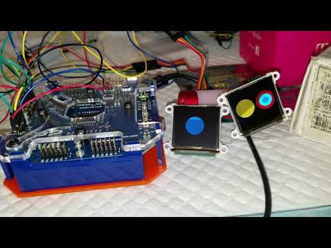

    EDIT: That works now. :) Those are comport commanded displays, right?

    Looks good, Pilot. Are the circles being computed in the P2 or does display have some ability to do that?
  • evanhevanh Posts: 17,283
    The display does it, here's an example from Pilot's source code:
    pub filledcircle(x0,x1,y0,y1,rad0,rad1,col0,col1) ' red
          screen.tx($FF)
          screen.tx($CC)
          screen.tx(x0)
          screen.tx(x1)
          screen.tx(y0)
          screen.tx(y1)
          screen.tx(rad0)
          screen.tx(rad1)
          screen.tx(col0)
          screen.tx(col1)
    Note: x0 is high byte and x1 is low byte of the one value. And so on for y, rad, and col.

  • Great work! What module is this? What chipset?
  • 4Dsystems Oled 126-g2. Parallax sold them years ago. Out of Australia
