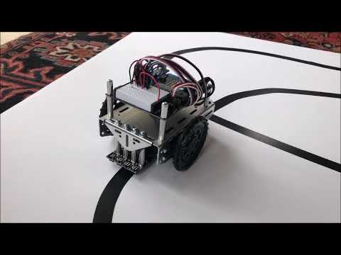

All, my son is using the Parallax high speed continuous servo motors (900-00025). They have a max RPM of 180. Are there any other servo brands/models that are plug and play with the WX board but offer a higher top end RPM. He has a competition coming up where speed matters and am looking to see if there are other servo options available. Thanks!

    You could also move the jumper over from Vdd to Vin to make the servos go even faster. Depending on the course, you'll need to consider the various states that the sensors report. Usually, these competitions have some challenges in them like broken lines, objects in the way, the need to navigate towards a particular direction which has more light (or based on a compass).
    After a bit of programming you should see the robot at least moving this fast.
