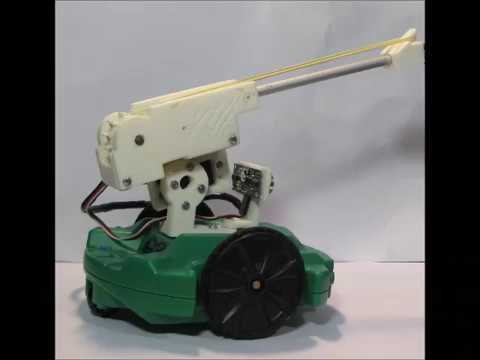

Hi all,
This is an announce from some activities of this year educational project with my students.
The project uses a 3d printed Rubber-band-gun controlled by S3 robot via hacker port with BlocklyProp
The inspiration project was the "S2 Marauder: 12-shot Semi-automatic ..." from Phil Pilgrim, an amazing rubber Gun for S2.
However I believe that the S3 Hacker Port, the 3d printers and BlocklyProp can make this project suitable and for not advanced makers and programmers.
That exactly was my main effort for that project that is still in progress...
Using that gun with BlocklyProp, I found powerful trigonometric commands that can activate students in order to use Maths better ....
In the next posts I'll give gradually all the activities and details of this project and I expect to improve it through the discussion, your comments and ideas....
For those with a 3d printer the parts are here: https://www.thingiverse.com/thing:2789905

    Here is a list of electronics and hardware for that project:
    1) Two (2) Parallax Standard Servo
    2) One PING)))™ ultrasonic sensor (or Ideal The LaserPING 2m Rangefinder)
    3) Laser head mini pointer from e-bay (Optional)
    4) Aluminum tube (Length:175mm, Ext. diam:8mm, Int diam:5.5mm). You can change the length according rubber size)
    5) A barrel 40 mm length 6mm diam for cog's assembly
    6) (10) screw 15mm and nuts (for servo and servo horns assembly)
    7) (3) srew 40 mm and nut (for gun's main body assembly)
    8) Rubber bands (choose the size according gun's barrel length)
    video

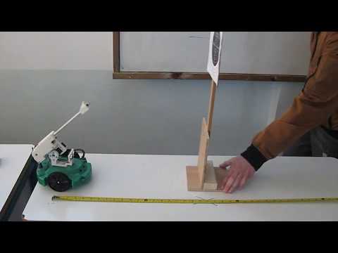

    For the educational scenarios we'll need some targets ...
    Targets could be anything however in order to test the shooting angles, targets must have a height. 60 cm is a very good height for close and distance shootinghs .
    It is also necessary every target to have a flat area near the base in order to be detectable from PING)) sensor (that area for my targets is 14.5cmX20cm).
    The entire target base is wooden and on top of it we can put a paper with the printed target..
    1270 x 828 - 268K

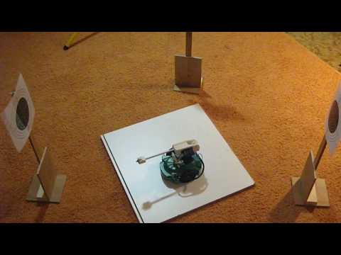

    Activity 01 (Azimuth)
    On activity-01 called Azimuth, we put targets randomly, inside a circle with radius =< 3m. The S3 robot must pivot and every time that locate a target toward in front of it, must stop in order to shoot. At the present time we avoid the shooting and we program the S3 only to blink its Led’s and waiting for a while in front of the target before continue the scanning the entire circle.
    The procedure is the following: The S3 pivot in a small step (Azimuth step=2 degrees) and simultaneously gets the values X from the Ping sensor that is the distance. Every time that x is smaller than max_detection_area it means that a target has been detected.
    Then the S3 light its LEDs for a while and then makes a rotation skip to continue the scanning on the rest part of the circle

    To continue the analysis of Activity 01, we have some stages, that is shown in the next animation:
    When the S3 detect a target, stop the scanning procedure (at this stage the gun it is not centered towards the target). Then the robot turns right for some degrees in order to center the target, then it shoot (light the red LEDs and makes a sound), and finaly skip the target, turning right again for some appropriate degrees.
    951 x 665 - 372K
  • NikosGNikosG Posts: 705
    edited 2018-02-26 19:59
    For the activity above you only need the Ping))) sensor without the gun.
    On BlocklYProp the corresponding program has the name: "Activity 01 Azimuth Rubber gun (NikosG)"
    Video

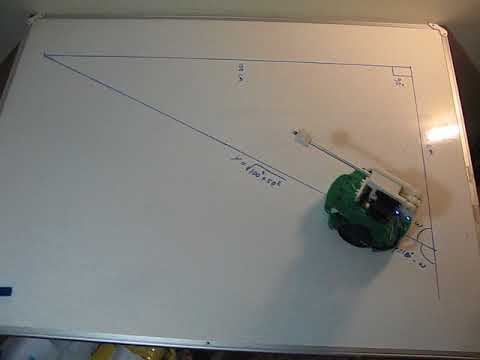

    Explanation of Activity-02 (Tilt)
    On activity-02 called tilt, the S3 is looking toward straight to a target (in a random distance), and it must adjust the tilt of the gun in order to hit the target.
    Here as you can see, we have a right triangle and we know the vertical side (h) (the height of the target, that is constant h=50), and the horizontal side (X) that is the distance between the base of the target and the robot. The horizontal side (X) can be changed but we can know it every time, using the PING))) sensor. On BloclyPROP the command in order to get te value of X is: “ X=Ping)) sensor on P2 distance in centimeters”
    The Tilt of the gun is the angle y.
    Using trigonometry, we can calculate the Tangent of the angle y, so… Tan(y)=h/y and then the angle y is: y=arc tangent (h/y). On BloclyPROP the command in order to calculate Y is: “arctangent of (h÷X) X 1 store in Y”
    In the next experiment we move the target in front of the robot. BloclyPROP using the method we described above can calculate the tilt and change automatically the gun’s position….
    Video
    Moving the target closer to the robot the tilt is increased. Moving the target away from the robot the tilt is declined... The gun always target the center of the target.
  • 72sonett72sonett Posts: 82
    edited 2018-02-27 22:15
    I would measure the horizontal distance from the PING back to the hinge point of the gun, call it 'a'.
    Then, as the height 'h' of the target and 'a' are constants and 'd' is the distance measured by PING, the tilt angle α = atan (h/(a + d)).
    BTW, from your earlier target drawing I would think h is closer to 40 cm than 50 cm.
    edited 2018-03-01 13:23
    72sonett wrote: »
    Yes you have right in some way....
    However the rotation center is that with the yellow arrow.... So The "α" you said, is a little bit different.....
    In fact we have some "Similar" triangles over there.......
    It doesn't matter which of them we are going to take because all of them have the same tilt
    I would say that is better keep the smaller one (with the clear d as a side ), and to "play" a little bit with the values of "h" in order to have the best result....
