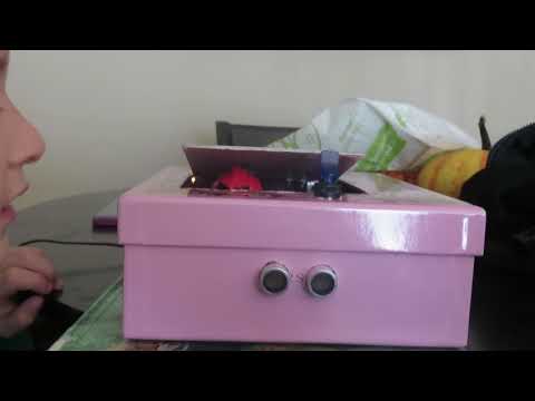

  • I'm going to post the good as well as the bad during this project, I'm positive the weakest link in this entire project is my ability or lack of to Program, but we learn by doing and by our mistakes....
    I finally over the weekend reinstalled the arm and servo (I had to change location due to design change) and now I was ready to start programing. I was able to get angry bird and the new arm to hit their marks exactly, I was very excited. The new arm ended up working perfectly, I still cant believe I couldn't come up with that myself, but we all learn. I will post a video if I can figure out how or in the very least more pic's.
    Now for the bad news.......
    I spent several hours with no luck trying to get EMIC2 and the RGB to work, if I had any hair I would have pulled it out. I do want to say I did test ALL devices independently of each other (outside the box) so if something is not working I either released the smoke in the device or I"m just not coding properly.
    The only reason I'm not posting any code for you guys to dissect is because at this point in the game with all the components installed in the box and wired I'm now making sure each device is working, so I've been writing separate code for each device and when something wasn't working I was just scrapping the whole thing and starting over.

  • Here it is pushing the switch.....
    1296 x 972 - 864K
  • Very Cool!
    Your bird looks good and angry >:(
  • Mikeologist:
    Thanks, he does look pretty Angry. I will be happy to get him out of this cardboard box and into a real, or I should say a Nicer box, but other then that I'm pretty happy with my progress.
  • That is a useful looking useless box!

    I finally accomplished getting both servo's to hit their marks. I disposed of the RGB's because I wasn't aware that they couldn't be run on a basic stamp.
    My next task will be to get the EMIC2 to make some sort of noise, but hopefully I will get a voice out of this thing.
    Since I had to dispose of the RGB's I decided to use a few LEDs in their place, not as exciting but it will do the job.
    Once I get these above task completed I will start to piece the code together. Thank you for all the comments and all the help this would not have been possible without those things.
