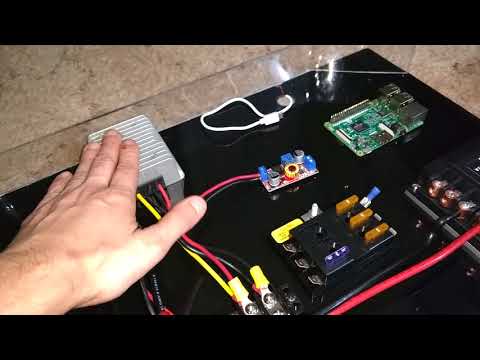

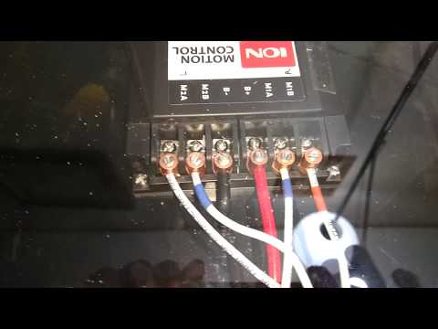

  • I posted only one of the videos instead of the four on my last post, here are the other three.
    Part 2
    Part 3
    Part 4
    My Powerchair Conversion Playlist that I add all my videos to (first being the most current)
  • JDJD Posts: 570
    Coming along great Jorge. My vote is if wiring or placement makes it easier, that is the correct way. Steppers would give better position controls than a servo too, and the pan/tilt with pings shouldn't weight much either. I can't wait to see it in operation to start live testing. :)

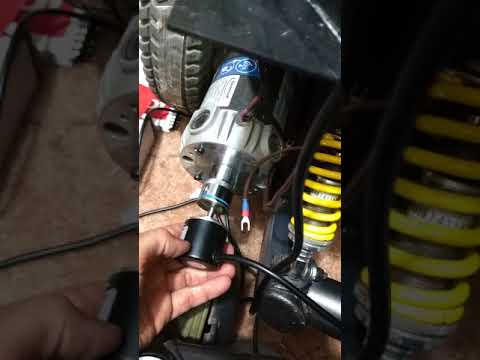

  • I'm running into a bit of a dilemma. I don't have a drill press and I need to have a straight holes into the side and filled drive hole of a 22mm socket to fit the socket to the encoders. The 22mm socket fits perfectly onto the motor shaft, if the brake is removed, without any play. The 1/2 inch drive hole of the socket is filled with epoxy so I can drill a 6 mm hole into the center to insert the shaft of the encoder using a second hole drilled into the side of the socket for a set screw. I only have a hand drill and I can't quite get a straight hole.
    Any suggestions?
    Here is a video of what the problem is and what I think needs to be done (it is still uploading if it is within 25-30 minutes of the time I posted this comment).
    The simplest solution for drilling 90 degree holes is to use two pieces of wood joined together to form a corner as a guide. There are also attachments for drills that can be used as a guide.
    If you could use a drill press frequently you can also build one to hold a corded or cordless drill using wood and drawer glides. Go to youtube and search for "drill press".
