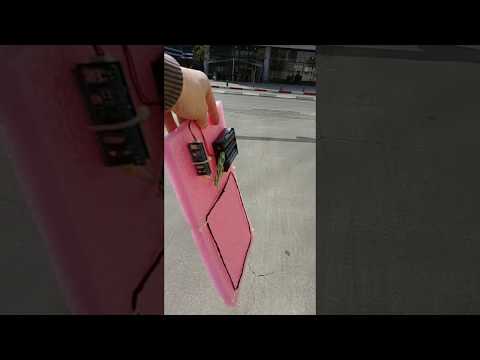

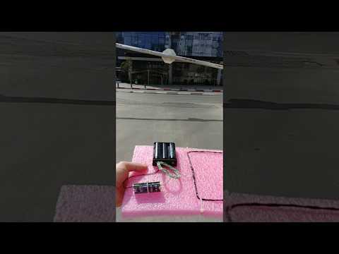

    I'm missing one diode and one cap to build that detector in the youtube video. I want to compare mass vs proximity. There seems to a lot of debate on some motorcycle forums, and very little testing going on. Another topic of debate is the use of magnets to trip the sensor, again, no real testing going on there either.

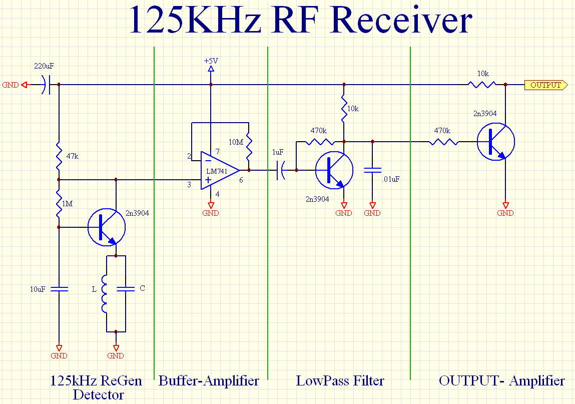

  • The Front end of this circuit works extremely well for what you want to do.... It basically is an emitter follower where the BASE of the transistor is fixed, and the actual input is on the EMITTER of the transistor. Since you don't know the exact frequency you will need to remove the capacitor that is in parallel with the sense coil so that the receiver becomes a broadband receiver. With this circuit I was able to sense an RFID door reader and decode the tag from 20 feet away with a 3.5 inch diameter coil tuned to 125kHz. All you need is the front stage "Regen Detector" ... the transistor COLLECTOR is the output and could be connected to a scope for testing.
    http://www.kit-start.com/RFID Receiver/RFID receiver_html_mf57f20d.jpg
  • Nice, thank you. I have the parts.

  • I would start with a mid range coil of 100kHz ... and then maybe 50kHz and 150kHz ... With this design you can switch out coils pretty easily, but remember without a capacitor in parallel you'll mostly just be receiving broadband (<-- Everything)
    I'll just open this page up I created about 3 years ago ... There are a few helpful files to calculate winding your own coils under "Additional Resources"
    visit:
    Navigate to the tab that says "Enter the RFID sniff project instruction Page"
    The password is "reddirt" and you need to press the "Submit" button... the ENTER key will not do it.

    BTW) This isn't really RF ... it's closer to Near field magnetic coupling. <-- Such a Google search might produce better results
    The "Exciter" mimics the Door Scanner you would normally place your TAG on .... The "Receiver" simply listens (at a distance) for a modulated signal.
    The "Sniffer project" was to exploit a security vulnerability in the current technology where a conventional RFID Door Scanner becomes the transmitter when a tag is placed on it. Even the so called "smart tags" used in hotel keys that negotiate a communication between the tag and the door reader are susceptible because this kind of receiver can "Listen" to both sides of the conversation. One of the requirements for the Sniffer project was to use common "off the shelf" components which makes the exploit even more alarming.
    Under optimal conditions and with an exceptionally tuned coil I was able to correctly read a tag placed on the exciter that was 20 feet away from the receiver. I have since improved this distance, but I can't release the schematics anytime soon. We haven't even scratched the tip of the iceberg, I'm working with a guy at the DOD on a project that may require a change in the entire infrastructure down to the checkout line at the grocery store.

  • I had to get into a local university car park, which was a pain as it wanted a card - but I saw that there was a loop detector over on the inside. By getting out and sticking a tool box over there the barrier would raise - I then noticed that if I stood in the right place, or marched about, the metal in my boots would do the same (cue Silly Walk imagery).
    Perhaps riding the bike whilst wearing deep sea diving boots ...
    I was thinking about adding a few layers of thick foil between the boot and Insole. I have some special foil on order, thicker than the thickest aluminum foil stores sell. Thin enough to not be noticeable.

    It seems like any type of metal will change the inductance of my test loop. I would imagine that ferrous metals have more of an effect, but non-ferrous metal has some effect.
    Metal detectors can detect both.
