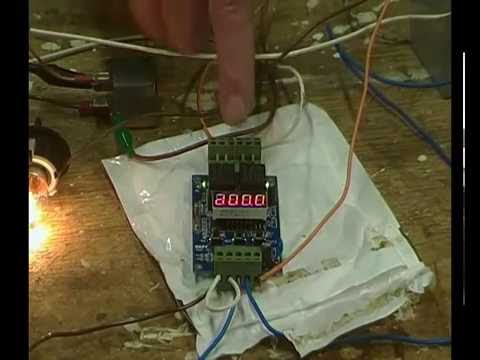

There is one more option here. It is a sorry one for Parallax.............evict the board,pc relays and current sensors.
Program the "VLC EAZY" to function on a voltage input of 12.3 stay on. The second EAZY relay that connects generator to
battery 12volts could power on the GERI relay.
I just don't know how to program the EAZY. I think its the 0005 setting for voltage detection. I would need both of those relays to stay latched.
How would it shut off? If I enter a higher voltage threshold "15volts?" it won't work.
It would shut off too soon because the system can reach those values in half the time but not be fully charged.
This would cause excessive generator run time. The cycles would be too short.

Based on the video it does seem like the EAZY might be able to do what you want, however I have no experience with it so I would not be able to help you.

Here is another example of the EAZY relay that the BS2's micro p.c. board relays activate when low 12.3 voltage.
Am I missing something here?
I don't know if this would do this stand alone.
