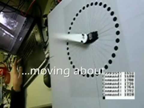

    I want to give you a headsup for a company that makes a very innovative servocontrol (just like the Propeller-Chip) that is much more acurate than even a digitical classical servo and which can be used even for much bigger motors than 20g-RC-Servos.
    http://www.01mechatronics.com/products
    Demovideo:
    It uses a magnetic encoder with a resolution of 10 to 14 bits per revolultion.
    Coincidence or not: This magnetic encoder is manufactured by austriamicrosystems
    (If I remember right this is the manufacturer of the propeller-chip-die ;-)))
