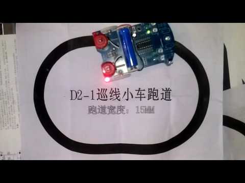

Grab a few of these $4.59 line follower kits before the price goes up, they were $4.36 when I bought on March 31. Once again, the sum of the parts is worth more than that! It's not programmable, just uses an LM393 comparator and two CdS cells to follow a line. Quick & easy build, works right away. It zigzags (alternating left/right motors) in its stock configuration, but I tweaked it and it's smoother & faster now. My video on top, someone else's at bottom.

    That conversion of yours works pretty good, you could put a camera mount on there, and go out on the main floor. I want to incorporate this on a line follower, it looks more confident in it's travels. It doesn't waste time and energy moving in a direction it don't need to go in the first place, which is kind of like travel by over correction. How is the sensor set up? Anything like the home brew line sensor you came up with a while back, reflecting a green LED off the floor back to two CdS cells?

  • Very nice! What was the actual mod you did? The video is a bit blurry.
  • ercoerco Posts: 20,259
    I'm writing that up for SERVO magazine right now! Basically rerouted the comparator inputs so that both motors are on in the straightaways.

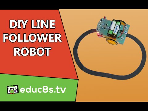

    Unboxing! Hahahaha...
  • erco wrote: »
    We need translation! He spent five minutes talking about what seemed to be the bag the parts came in.
    The guy is Italian, and it's hysterical how he talks with his hands.
    Many Ebay sellers don't ship to Italy since packages disappear in the mail. So this unboxing video is a rare treat from my favorite country, la mia Italia! If it's from Sicily, even better. Amo Sicilia!

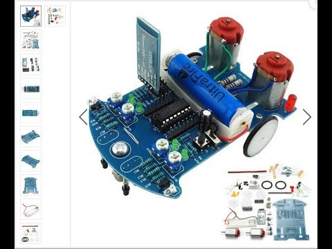

    Banggood sells a Bluetooth/obstacle detection/line follower version for $11.91, best price I've seen. Several obvious differences from the photo/schematic:
    Worm gear drive vs gearmotor assemblies
    Phototransistor line sensors vs CdS cells
    Microprocessor+comparator vs comparator only
    H-bridges vs single transistor (fwd/reverse vs fwd only)
    14500 Li-Ion battery vs alkaline
    Bluetooth module (duh)
    There may be a treasure hunt involved to track down the smartphone bluetooth tilt-drive app.
    http://www.banggood.com/D2-6-DIY-51-MCU-Smart-Car-Kit-Bluetooth-Remote-Control-Gravity-Sensing-Tracing-Obstacle-Avoidance-p-1108390.html

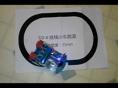

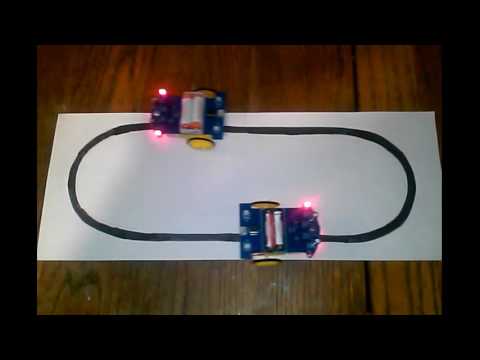

    Where else can you get a swarm of robots (three anyway) for under fourteen bucks? Each bot still needs something to interact with, either a forward-facing flamethrower or a pyrotechnic charge on the rear bumper, maybe both. Will advise.
    BTW the thumbnail shows my simplest mod yet for smooth driving. Cut trace to isolate IC pin 3, then connect pin 3 to the far side of R7.

    After some online sleuthing for details, I built up one of the fancier $12 units with obstacle sensors and Bluetooth control. The doggone thing actually works! Stock line following is actually worse than the $5 car, but I can tweak that. The Bluetooth app lets your smartphone drive it by buttons or by tilting your phone. Will add a video later.
    erco-approved, nab one for yourself! This one has real H-bridges for reverse, the $5 version has forward only. IMHO this one is a great candidate for hacking, it might be the cheap merit bage robot people have been looking for. The sum of the parts is certainly worth more than $12. Kit comes with a preprogrammed STC15W201S processor. You can learn to program that (UGH) or chuck it and hack on your own favorite processor.
