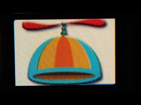

  • Made more progress tonight. I think I understand more as to how the buffer works in the SSD1306 driver and how it should work for the SSD1331. It's two bytes per pixel vs 1 bit.
    I used the SSD1331 driver's data commands to attempt to display the propeller beanie hat, and had some success. This was all done in spin. I just need to determine why colors and xy is wrong. I think I can figure it out if I can find the time.
    --Terry
    1574 x 885 - 232K
  • More success. Attached is the image of the bitmap of the propeller beanie hat on the display. This was done in Spin and PASM. I will release some demo code as soon as I can. There are a couple of bugs to quash.
    I think I will implement the draw and copy functions that are native to the display first. Then I will attempt to implement the font/text printing routines.
    I am having a lot of fun with this :)
    --Terry
    1440 x 810 - 112K
  • That beanie is looking fantastic in color.
    Great going Terry. Fun+++
  • The next big question now is: To frame buffer or not to frame buffer.
    The downside to the frame buffer is it uses 12K of RAM.
    The upside to the frame buffer is you can manipulate the buffer and then update the screen all at once. The update could be super fast, as the whole thing could be done in PASM.
    If I do use a frame buffer, I will use the beanie hat as the default values in the buffer. That would be a cool because on initialization, you would see that image.

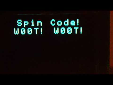

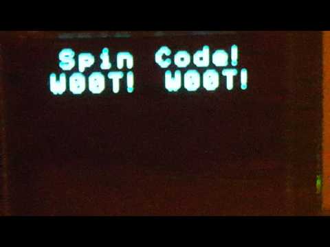

  • And now the 5x7 fonts work too! W00T! I never thought I would actually get this far.
    Code to display 5x7font text is as follows:
         OLED.clearDisplay
         OLED.write1x16String(String("Spin Code!"),10,12,0,$2F,$5F)
         OLED.write1x16String(String("W00T! W00T!"),11,8,10,$2F,$5F)
    Let me do some code cleanup and I will post the source in this thread. Still a lot of features to implement, but we be spinnin' baby! W00T!
  • OK, OK, last video, then off to bed. Sorry for the autofocus.

    Attached is a current copy of my code. I need to add proper interpolation of 16 to 24 bit color.
    Rectangles and lines have been added. Take a close look at the code to see how quickly it draws lines. :)
    @Publison Let me know if this version does not compile. I suspect there were competing file names.

    New version. (v.3) Now will unfilled rectangles and screen copy command.
    Be sure to use web safe colors as my 16bit to 24bit interpolation is brain dead. I just multiply Red by 8, Green by 4, and Blue by 8. I will circle back to this.
