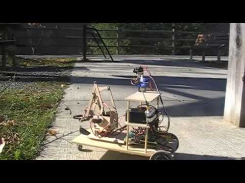

I'm not actually going to try to build a remote controlled snow plow. I was commenting on what was possible. I'm more interested in what vanmunch did when he built a mobile bot with an arm and a camera. I think he controlled it with a computer.
FPV and a portable transmitter that sends instructions instead of servo signals are 'game changers' IMO. Range is secondary at this point.
