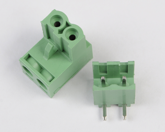

The plug portion uses screw connectors but then the socket portion is soldered to the PCB. I'm not sure about the current rating of these connectors but they seem relatively heavy duty and they're really convenient to use.

I'm planning on using these connectors for the main power.
