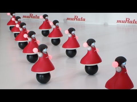

It would be nice if the center of gravity (CG) was a bit lower. I've noticed several Arduino projects that put the motors and stuff into a rolling hamster ball. What if the MOVEMENT (M) motors and batteries were in the ball and you could command them via di-directional IR (BDIR), oh and the BALANCE and DESIRE (B-D) stuff was on top of the ball (current tri-bot concept)?

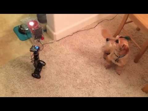

Erco I think the two wheeled balancing bot did have some reaction time issues (see when it is on the glass plate that is tilting back and forth under it).
Even though it was able to go up a hill and back down with "lean", I wonder if it's reaction time would allow movement across the door threshold.
My threshold was purchased at Home Depot and has a quarter circle entrance and exit ramp. It is not an inclined plane as seen in the bot video.
Should the testing for obstacles be an inclined plane, if so what is the maximum degree?

Don't you think Murata cheer leading robots satisfy most of EVE requirements ?
[video=youtube_share;KNi_WLYoRNY]
Kaeru no Ojisan
