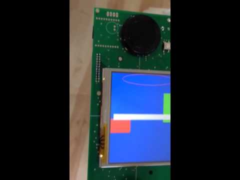

    Was just playing around with doing graphics updates during vertical refresh...
    It looks like it might work. See here for a video of it working: [video=youtube_share;snfeXGSdbF4]
    This is really basic, clearing the screen and then drawing a few blocks and an ellipse.
    But, this was mostly spin. If pushed to assembly, should be able to do more...

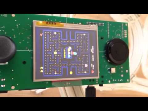

    Here's a better sprite demo
    Moves some spites around using bitblt and transparent blit

  • RaymanRayman Posts: 16,448
    edited 2014-10-08 02:54
    Thanks for asking. It's coming along, although I don't have very many hours a week to work on it...
    I've completed the assembly driver and the pac-man type demo runs much faster now.
    It's very clear now that drawing during vertical refresh is possible and I'll work on some better demos of that soon.

    This has been a very long design process, but I think the hardware is finally done :)
    Just populated the latest prototype PCB and everything is working (without jumper wires this time)...
    Also, I've got FSRW working with the 4-bit full-size SD card connected directly to the SSD1921. I think this will be great for moving images directly from SD to screen buffer, with option of jpeg encode/decode in between.
    Camera port works, touchscreen, jog dial and joystick work. RTC works. 9DOF mems works. Power works via jack or USB.
    Still need to test a few extraneous things like TV output, IR transmit/receive, Xbee port, nunchuck port, lipo charger, etc.
    Testing is actually a problem for this big board... Many things to test...
    But, once that's done and I touch up some silkscreen, I'm ready to place the order for production boards.
    BTW: I think I've decided on "Manta" as the codename for this board.
    I also need to pick a soldermask color. I've always done green in the past, but this time thinking about blue or white or black...
    Here are photos of what I think is the final prototype:
    1024 x 768 - 72K
    1024 x 768 - 122K
