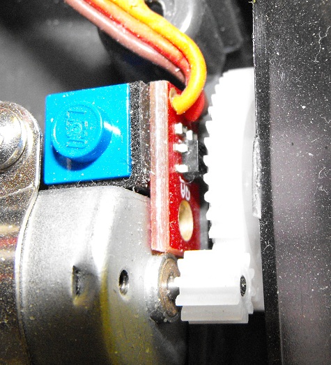

I'm having trouble getting a clean high/low response from my IR emitter-reciever module. I'm using an LED in series with the detector to show when it conducts and it only goes from dim to bright.
I scavenged several RPR-220 reflective modules from a discarded document feeder and found the datasheets online. My encoder disks are 'about' 3mm from the detectors. The disk resolution is 44. (I guess that means 44 pairs of stripes.) I put a 15-turn trimmer in series with the emitter to help find the sweet spot.
How do I get a clean high-low signal? Comparator? Schmitt trigger?
    edited 2020-08-29 22:49
    I would think the LED in series would cause trouble. The signal isn't meant to provide much current. If you used it with a QuickStart's I/O pin P16 to P23, then you could have your LED and signal too. (That was supposed to sound like "have your cake and eat it too.")
    Also 3mm seems kind of far to me. Here's a picture of encoders I added to a Roboni-I robot.
    94288
    As you can see, the sensor is awfully close to the gear with the stripes. The gear was transparent to IR so I added a layer of Al foil so the IR would reflect back to the sensor.
    The P5587 encoders include a Schmitt trigger and works really well. You still need good light and dark areas. Some black material isn't so black when the light is IR. I originally used Gorilla tape for my black area in this experiment but switching to black masking tape made a big difference.
    It's also a good idea to have a pair of encoders (quadrature) so you can detect which way the motor is turning. The quadrature encoders will also make sure you don't count transitions across the same boundary (going forward then back) as real movement.

    Duane Degn, I'm learning. After reading your post then researching 'Schmitt trigger' and comparators I realized I had to digitize the signal. The bright-to-dim response I saw was analog. I placed the IR detector about 6mm from the encoder disk based on what I thought was a recommendation from the datasheet. I'll move the detector as close as I can to the disk.
    1024 x 768 - 69K
    1024 x 768 - 89K
    edited 2014-07-21 09:00
    I know I had to experiment with what material the stripes were made from and I also had to experiment with the distance of the sensor to the stripes to find the best combination.
    One concern I have is if the sensor can distinguish the individual stripes at that distance. Is it "seeing" more than one stripe at a time?
    I don't know how you have your setup wired but you want to protect the Propeller I/O pins from too much current through the clamping diodes. With the I/O pin set as an input, the current through the clamping diodes should not be more than 500uA (0.5mA). A 3.3K resistor will keep the pin safe from a 5V signal.

    That's your problem. A Schmitt trigger or comparator can certainly be useful, but your sensor is seeing more than one stripe at a time, and no additional electronics will make this work reliably. You either need to get the sensor right up against the encoder, use a different sensor with a smaller aperture, or use a code wheel with (far) fewer stripes. Start with 6 or 8, and work your way up from there.

    You could add an aperture (blinders) to limit your sensor's field of vision. And measure the output (scope) from the IR PTX before filtering or Schmitt trigger. Here's an interesting old read on troubleshooting a homebrew encoder sensor: http://list.dprg.org/archive/1998-July/005620.html

    The mechanical construction of your plywood (yea, plywood!) bot ought to make it real easy to adjust the distance between the sensor and code wheel. A slot in either the base or sensor mount can allow you to test various distances. You ought to be able to adjust it so the sensor is just a hair width away from the wheel. Of course, all wheels will have run-out (wobble), so be sure the servo screw is all the way tight, and adjust the sensor for its closest distance.
    Folks often over-complicate encoders. The Big Trak toy of the 80s, which people could program for fairly accurate moves, had a wheel encoder with maybe 10 or 12 holes in it. (And at that it only had one of them. The two wheels were kept synced by using a novel magnetic differential clutch.) If you can get your 44 stripe encoder to work, that's great, but an 8 or 12 stripe wheel works very well, too. Beyond that the frustration quotient increases exponentially.
