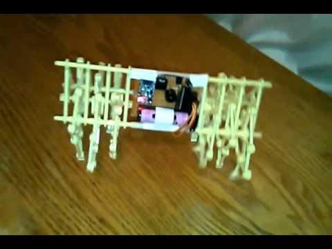

Hacking an Ebay China $10 Theo Jansen "Strandbeest" kit into a differential-drive walker using continuous rotation servos. Same 9g servo & CR mods used in Spike: http://forums.parallax.com/showthread.php/151632
Coupling one crankshaft to its servo: http://www.youtube.com/watch?v=kSADSBj-xrQ
Legs on one side powered by a servo tester: http://www.youtube.com/watch?v=xq4AbO_xZu8
My favorite serendipitous discovery is that after installing both servos and extending the chassis the requisite length, the resulting center gap is sized perfectly for my favorite 15-cent 5cm x 7cm perfboard: http://www.ebay.com/itm/261340136969
Now I just have to decide what new feature to build into this bot. I'm bored with fire, lasers, & rubber band shooters. What's a bot to do?

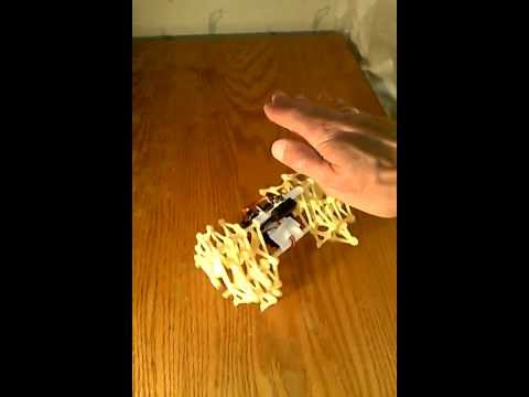

    edited 2014-02-26 08:37
    Gesture control with a Sharp IR sensor is pretty engaging, my kids like it. Would work as well on a BoeBot or Activity bot. Put the power in your hands!
