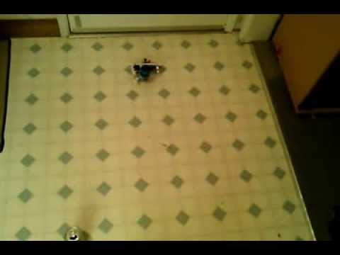

First test of the Terminator, my entry into the Coasterbot contest, a multi-sensor robot using a CD as a chassis. On-board laser targeting system locates small reflective stickers on cans and blasts them with rubber bands. BS2 controlled, the sensors include a Hamamatsu S6986, a PING rangefinder and the distinctive tick-tick-tick of my mechanical 4 PPR wheel encoder on the tricycle drive wheel, driven by a DC gearmotor. Standard servo steering and another 9g continuous rotation servo on the rubber band fire control system! More to come, speech & IR control, but I thought this first test was encouraging enough to share.

    Testing my new camera. Some bot shots, with Parallax gear visible on the business end of the shooter: a PING up front and a pretty red BS2E in that transparent dollar solderless breadboard from Ebay. I practice what I preach!
    That rubber band gun "escapement" is as simple as it gets. Slow to load, but deadly accurate. It's never missed a can in two dozen demos.

    Butt to nuts close. You can see a top view at http://forums.parallax.com/attachment.php?attachmentid=103390&d=1376708680. Laser is on the right, sensor is right under it. You can see four pins extending left into a socket. Will share a full frontal (?) pic soon.
    edited 2013-08-22 07:15
    So I’m assuming you did not use a lens on the laser sensor. What’s the detection range? A meter or less?
    edited 2013-08-22 07:16
    8-10 feet, no lens with the best reflector. Not bad!
    With a lens, I'm guessing 20-30 feet.

    Laser-tracking to a reflector: http://www.youtube.com/watch?v=4EVBZaRF80o
    Actively steering toward the right edge of the reflector.

    Naturally, three reflectors allow running a triangular course. Easy peezy, DD! http://www.youtube.com/watch?v=beoNr5vsbGw
    edited 2013-08-31 20:07
    My official robot video for Jameco's contest. Rushed and imperfect, but it shows the potential. This bot has a mechanical 4 PPR wheel encoder, which I haven't even used yet. There is a figure 8 in this bot's future.
